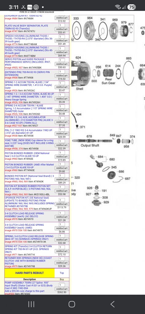

I have searched the forum and it was fairly unanimous that i have a damaged oring that goes in a cup on the output shaft. When i take the tailshaft off, it does not apear as i have the part in question. I have attached a pic to show the part. Do all 700r4's have item 958 and 374? Also this yoke is one i bought used from a guy that said it was for a 700r4. My old th350 yoke fits , but is shorter. Are there different yokes for a 700r4. Maybe I have the wrong one? Please help. This transmission swap has been nothing but headaches

Remove the driveshaft and install a rubber cup plug (like a wheel cylinder cup) into the end of the yoke with gasket sealer. The problem comes from the yoke splines wearing and letting fluid into the yoke. This fix has been done on many many vehicles over the years.
