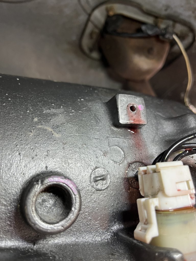

What’s up everyone.
I have a 700r4 transmission and after starting the truck (K10 4x4) transmission fluid starts to bubble out of the square part that sticks out from the case. It’s on the driver’s side of the vehicle up above the square electrical harness.
Have any of y’all seen this before? Can I just weld it closed or maybe epoxy it? As far as I can tell it’s not a “high pressure” point so maybe it’s not a big deal? I’ll attach the picture so you can see what I’m talking about.
Thanks in advance for any help and input.

Here’s the picture

I guess someone along the line put a screw in there to hold some kind of bracket and cracked it?
Like I said before, it shouldn’t be high pressure. It doesn’t start to leak until a minute or so goes by and it’s not a heavy stream of fluid, it just barely bubbles out.

That’s the mounting point cast into the case for the electrical harness. Originally, it had a self tapping screw threaded into it.
Either the hole is drilled deeper than it should be, there is porosity in the case, or someone threaded the wrong screw into the hole and cracked the case. Whatever the cause, it’s no big deal.
Clean the aluminum throughly, mix up some JB weld, fill the hole. If the hole is still needed for the harness, thread in the bolt before the epoxy completely sets up. Problem solved!!

I was hoping someone would say that. Lol
I’ll get her cleaned up.
