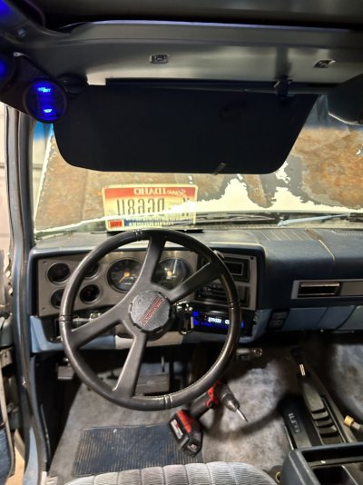

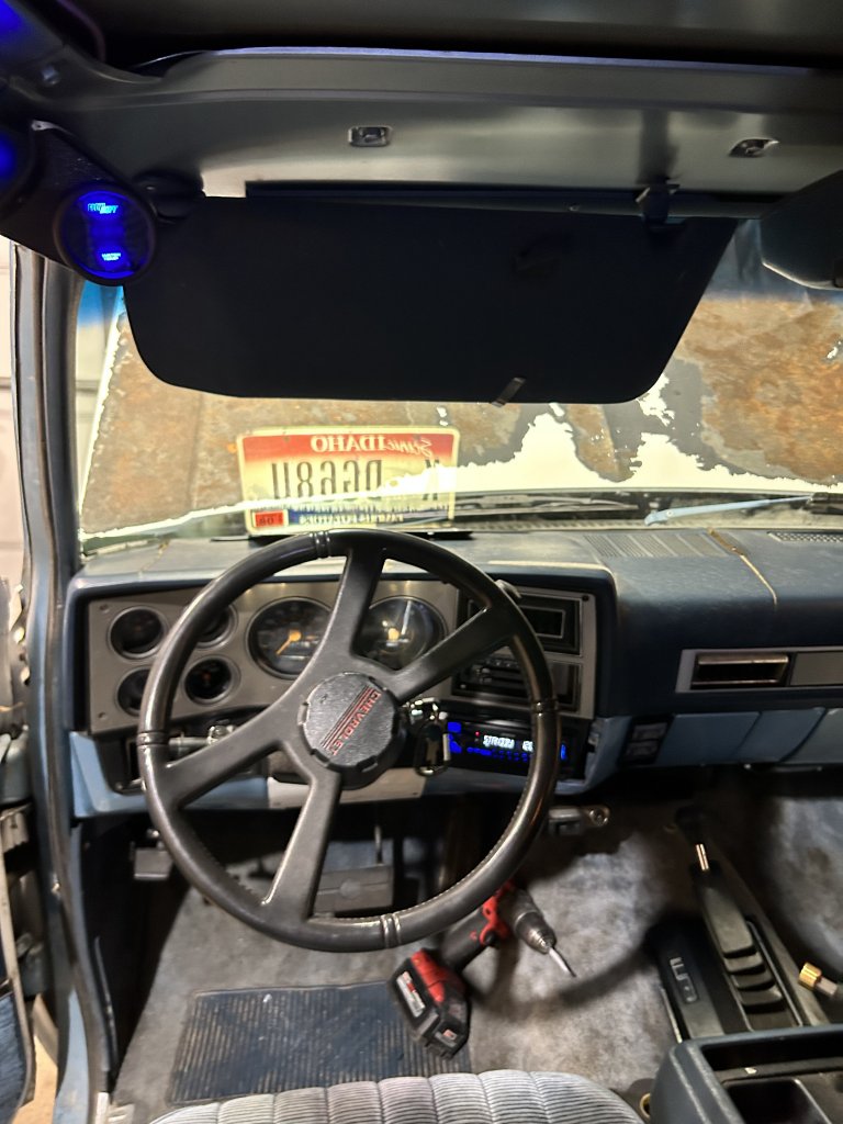

thanks for all the great input!! everyone, here is a update
just installed a glow shift temp gauge got all the wires routed and gauge mounted,
tomorrow i will get the temp sensor installed i plan on putting it in the thermostat housing to get a accurate coolant temp with out the exhaust manifold heating up the sensor
the computer uses the temp sensor next to the thermostat housing. so don't use that location.
