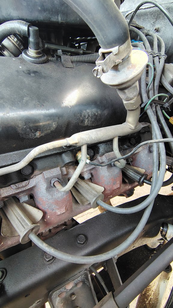

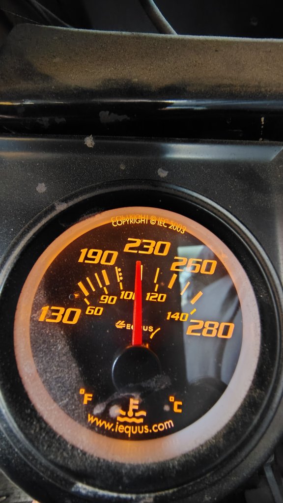

Fershure man the new rad will probably help out heres the cheap equis gauge on mine reads 230 normally but will go up to 245° when I'm doing a long up hill (there's a 50mile uphill grade where I live have to go up when I go visit my mom in the boonies) hopefully you get it where you like but like I said engine is probably ok as long as your not boiling over
