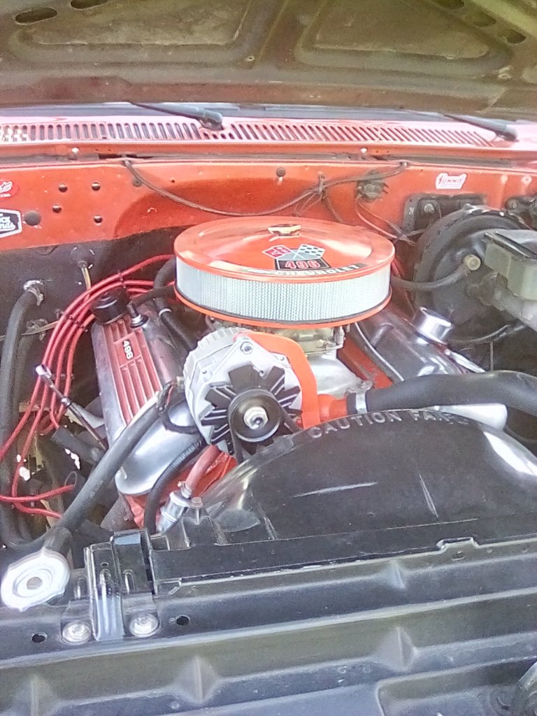

496
My 496 is a 454 bored over .060 with a Skip White 496 rotating assy. 781 iron heads, headers. I added a extension to place the direct drive 7 blade fan deep into the shroud. Running a high flow pump, 3 core radiator with a 165 t stat. This BBC runs cool as cucumber. I have the sensor in the intake. It rarely gets above 170. I shot the heads with my heat gun and they average around 190. No A/C.
