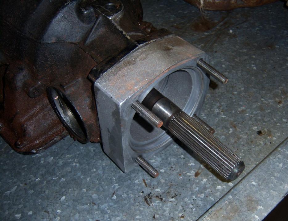

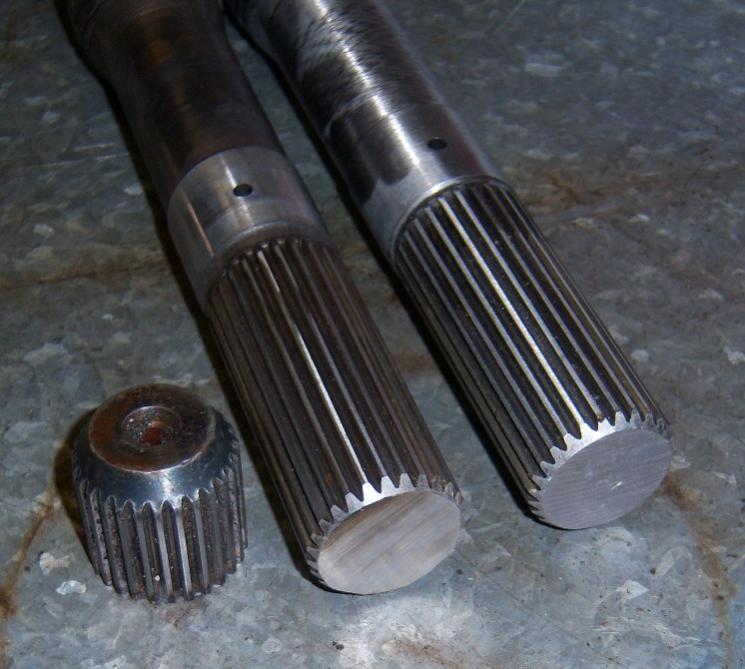

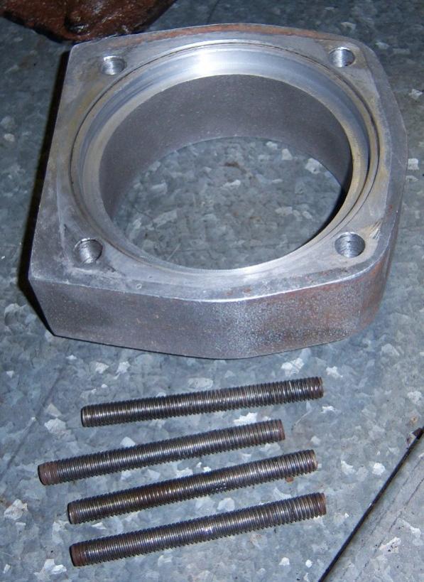

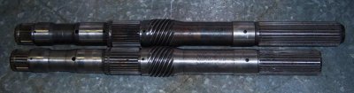

You use a 2wd short shaft transmission. Cut the amount shown here off the output shaft. Put in the 4 studs in the transcase. Slide the spacer over the studs, then slide your Tcase over the studs. Nut it up and there you go. Now you have a Th350 the exact same length as a 700r4 so no driveshaft mods, no moving the crossmember, nothing. Same cooling lines, Same TV/Detent Cable hookup, and add a Vacuum modulator line. DONE !!!

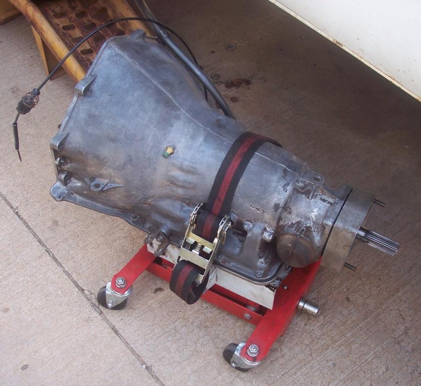

YEP, you have to for the added length of the output shaft to compensate for the spacer. Here's what it looks like going in the truck. This is assuming, he's currently got a 700r4/NP208 or NP241.
