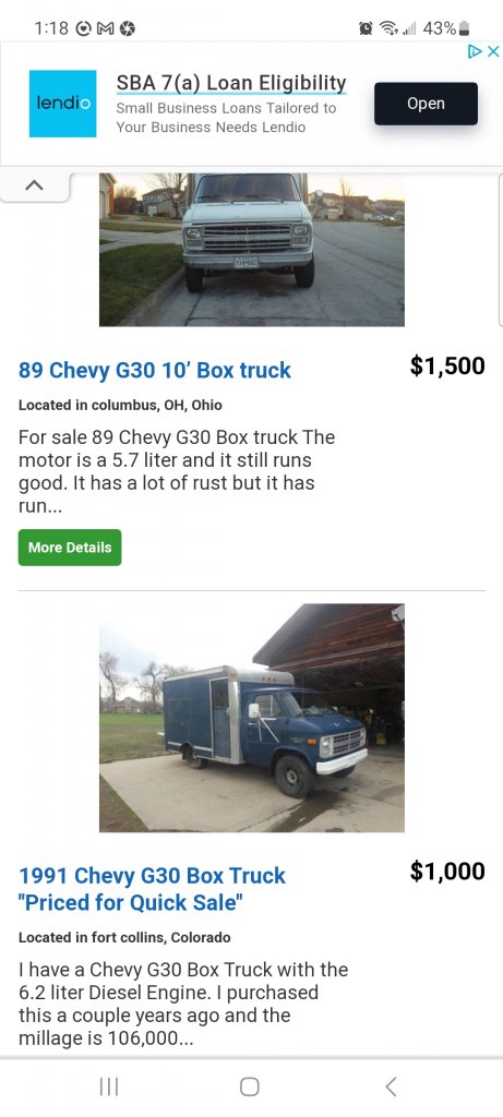

Sir some things you need to notice,my truck has 3.73 gears and in my opinion to daily that rig you are going to need comparable gears. I'm on mostly flat land. The steeper the gears you go the more your milage drops as does your highway speed. I don't think your truck has the right combo to daily drive pulling 5k. If that were my intentions with that Truck I'd run less gear,a th400 or 4l80e and more engine a 350 at minimum. The bigger engine has more potential to make low end torque,which without steep gears you are going to need I tow occasionally not 5k daily. I also think using that truck as a daily pulling 5k is going to wear it out fast. And pulling a trailer daily would suk. I think I'd try looking for a g30 box truck, or a 1 ton diesel flat bed,to make a daily work horse welding rig out of. I found these 2 in seconds and I think either would be a better choice, better brakes,better suspension and no need to pull a trailer,scout around. Keep your Square as the nice truck that it is. The 6.2 box trucks get amazing gas milage,for as big and heavy as they are
