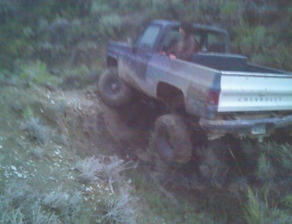

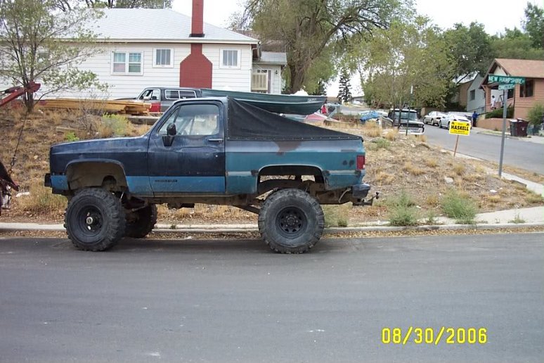

these pics is of my old blazer it donated the axles for this build loved it
