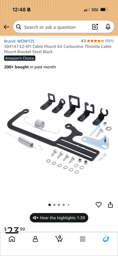

I don’t have a picture of the current bracket I have but my throttle and tv cable are to far in to align with the linkage on my eldelbrok carb. It’s a stock style bracket that mounts off rear intake bolt and off the stand off bolt behind the carb. I am planning to change over to a q jet carb after I get it running and the carb rebuilt. Just tying to get it going at this point. Has anyone used these throttle/tv cable brackets

There's going to be more to it than just changing those brackets. If you get TV geometry wrong you will burn up your transmission soon. And just because you bought a correction lever doesn't mean it's right. I've seen it twice that I know of the that the correction lever still didn't get the geometry right. @84-C20 is running your same setup since I tagged him maybe he can fill you in on the details. I know his is right.

That’s why I’m asking because I don’t wanna blow up my brand new transmission.
