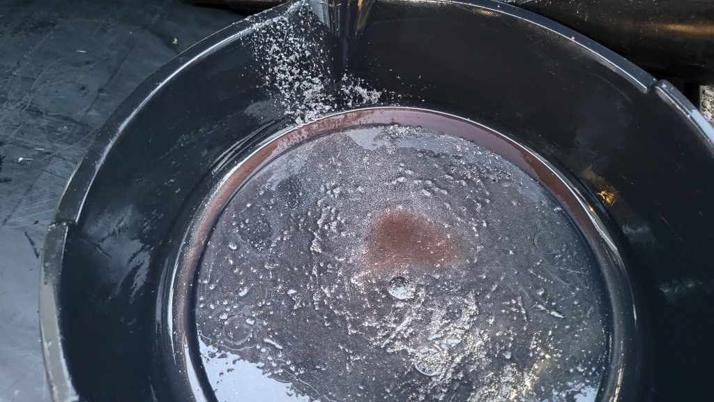

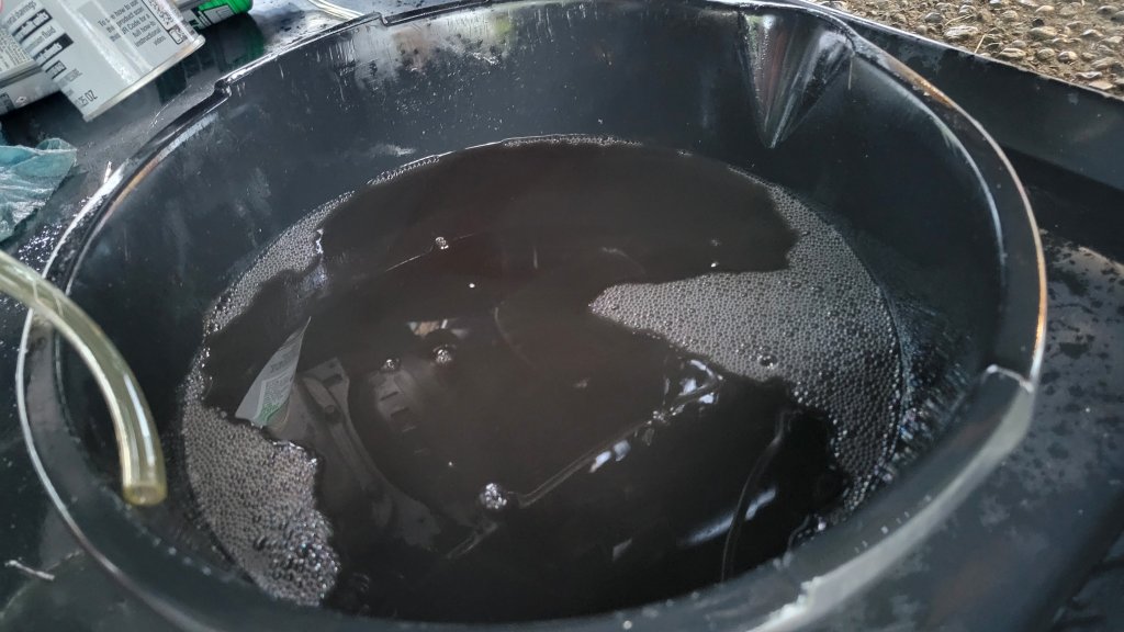

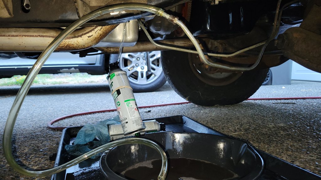

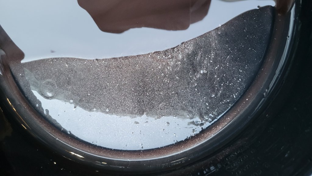

Flushed the trans lines before hooking them up to the rebuilt TH400. I didn't expect to see so much metal debris.
Hoping to wrap this up this weekend.
magnetic inline filter in the cooler circuit will be wise

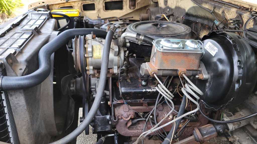

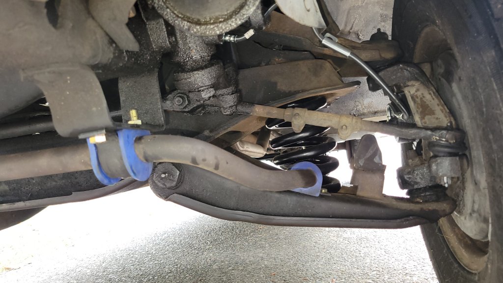

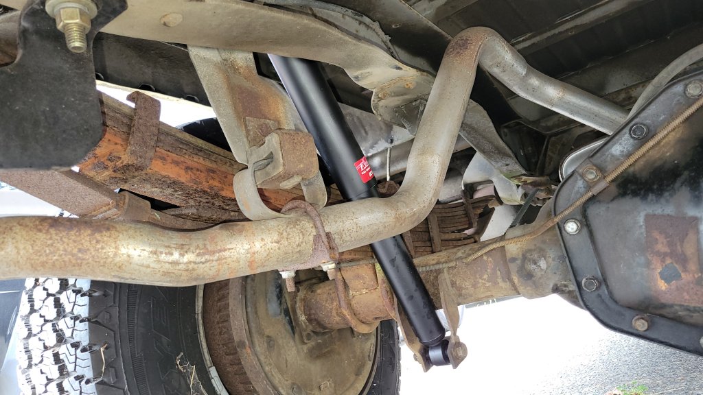

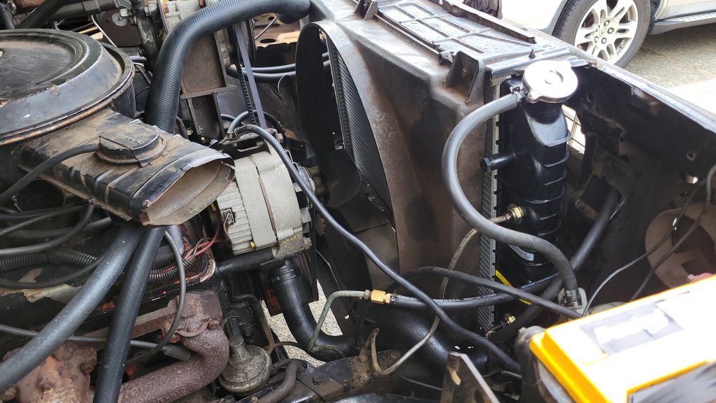

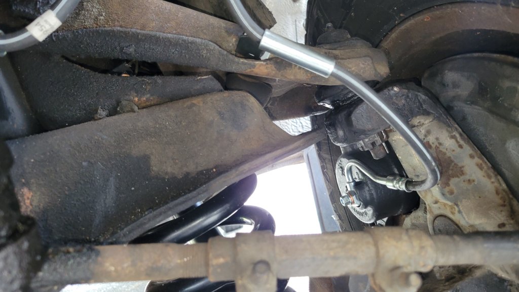

This truck needed A LOT of work because I hadn't maintained it well the 20 years I've owned it. I finally was able to put everything back together, start the engine, and run through the gears; it seems to be shifting great so far.
Here's a list of everything I addressed over the last 4 months as I got deeper into this thing:
- Of course, the trans was rebuilt
- Front coils
- Front stabilizer bushings
- Front and rear shocks
- Brake booster
- Master cylinder
- Front calipers and hoses
- Rear wheel cylinders
- Main bearings
- Rear main seal
- Cooling: radiator, rad hoses, water pump, heater hoses, and thermostat
- Transmission hoses were a mess of 3/8" hose clamped tightly onto 5/16" outlets
- Valve cover gaskets
- Rear diff fluid
- AC, PS, and alternator belts
- PS return hose
- Probably something else I'm forgetting

carb return spring, booster check valve/hose, and pcv valve hose, and breather on opposite cover, can you show me how all those are closer up? (the springs need to be replaced with a dual set , so i dont need to see it up close)

Thanks. I only use this truck several times a year for hauling. I hadn't maintained it well over the 20 years I've owned it, so I decided to fix as much as possible while it was down with a failed transmission. There's still some work left, but it drives great and feels more reliable.
