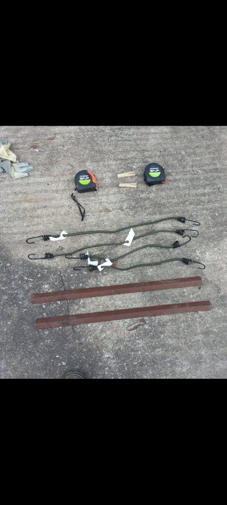

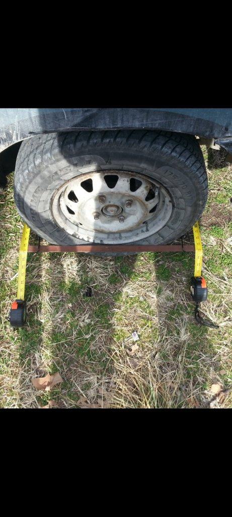

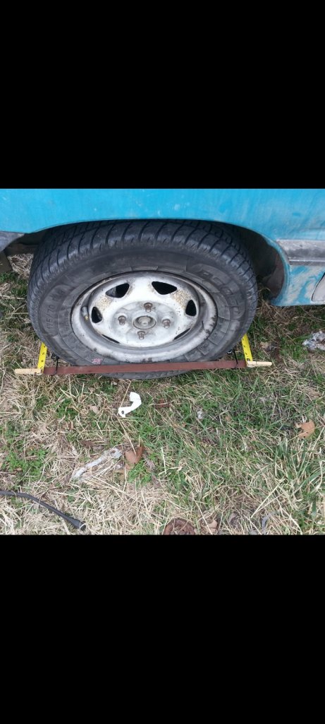

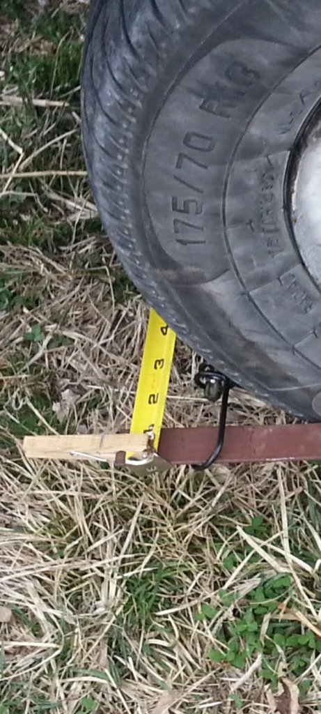

Okay actually not version one I used to use angle set on quart paint cans. Went this route a decade ago maybe, but went with longer angle after I took these pics, longer makes toe changes more noticeable. The bungee straps go under the vehicle 1 in front of the tire 1 behind the tire put the angle up high enough the sidewall bulge at the bottom isn't affecting their position. When I say 1 in front 1 in back its actually its 2 in front 2 in back because 1 won't reach all the way across. I still think a string box is more accurate, but this is so fast and easy,and really good enough as long as you check it often.
