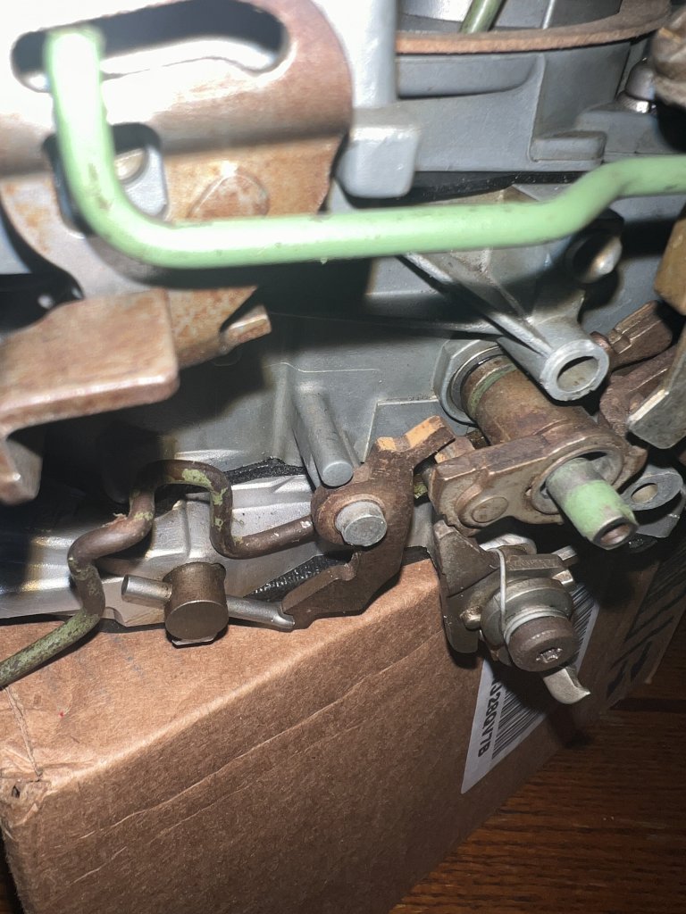

Ok so quick update:
I am still troubleshooting the high idle i did find a small vacuum leak at the carb base plate but from undertightening not overtightening. But my idle is still high between 800-900rpm at normal operating temp.
One thing ive noticed is that when i first start it “cold start” it has a low idle 600-700rpm during the time that should be fast idling then as it heats to operating temp it increases to the 800-900rpm range which is where it currently stays at. Ive tried messing with the mixture screws and tuned to max vacuum which is between 19-20inhg.
The normal idle speed screw is fully backed off and still the idle remains between 800-900rpm. Ive included a picture of it fully backed off taken while idling once warmed up and you can see the gap i dont know if thats normal.
If the gap is abnormal could this be an issue with the electronic choke? Ive read a few posts about issues the electronic choke can cause.
If not the other main issue that comes up when i search the system is another vacuum leak but considering I’ve already went through most the hoses and around the intake manifold and base plate i have no clue where it could be. I even double checked these areas after repairs to make sure there wasnt a leak still present.
If you have any ideas what it could be, all input is appreciated. Thanks

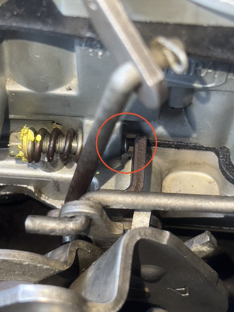

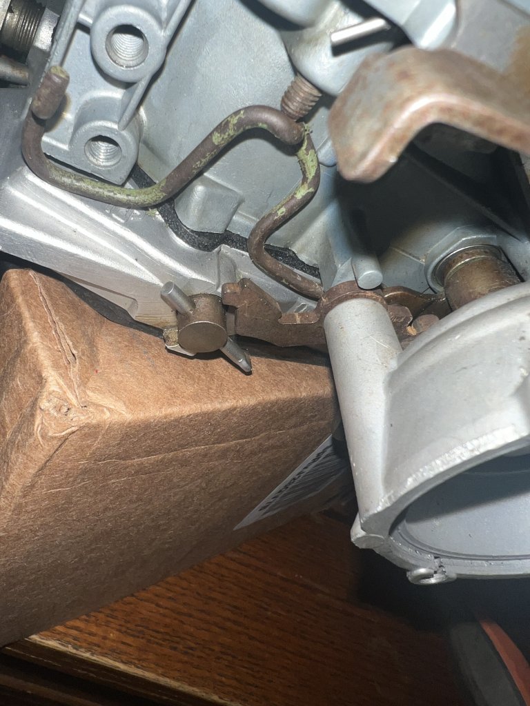

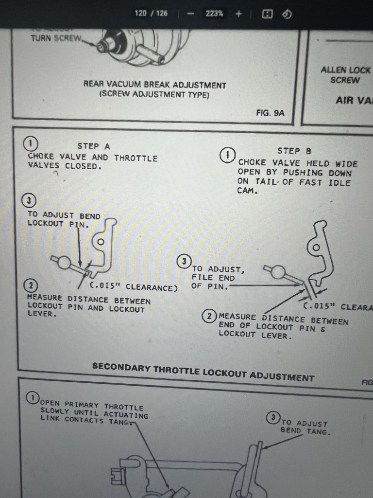

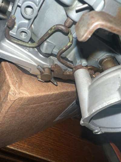

Alright so I fixed 2 issues and I found potentially one. Now my engine is idling at about 850rpm in Park and 550 in Drive or Reverse. Is this within normal range for a 305 or would this still be considered high?
The first issue I fixed was my rear vacuum break connecting rod didn't seem to be operating correctly so the fix for that was just bending it so that it could actually be pulled when the rear vacuum break pullled a vacuum. Simple enough.
The Second issue was an error that was completely avoidable but I obviously didnt read the instructions as thoroughly as I should have and went straight to the video tutorials. This issue was the cam secondary lockout not in the right position so it actually never locked out anything and was just kind of there. (I'll include pictures of the before, after, and where i finally noticed my issue in the instructions).
But this lead me to my potential issue.
After reinstalling the carb which I had to remove to perform repairs the car seemed to operate smoothly fast idle started around 850 and moved up to just above 1000 before it warmed up and kicked over to curb idle. and curb idle was at 800 in Park at fully pulled back. However, in drive it was only at 500 rpm which made the engine run a little rough and seem like it had the potential to stall. So I pushed in the idle speed screw a little to up the idle to 850 in Park and 550 in Drive and now its sounds nice and is running clean and no longer sounds like it wants to stall when put in gear.
The issue is the secondary choke plates (? not sure on correct term, not the throttle plate) didn't seem to be opening after warm up at full throttle given. This is what lead me to even check the secondary in the lockout in the first place because I thought maybe it was getting caught due to improper installation, which turned out to not be the case. I will say that the engine was running for about 10 minutes or so. My thermostat has midway at about 210 although I read that operating temp is about 195. My engine was under 210 when I checked and near enough that I would have assumed that it was already at operating temp. It is a hot 95 degrees already outside today. But even when i pressed the throttle all the way by hand using the throttle linkage (rpm 2100+ but not held there for more than 5 seconds max) the secondary choke plates never moved.

1. Is an 850 in Park and 550 in Drive an okay idle setting to leave the engine at?
2. Is there anything that I am doing wrong as far as getting the secondary choke plates to open? Maybe not holding the throttle long enough or should I have let it ran for longer to let it warm up more before I tried? I will continue checking it out and see if I missed anything.
