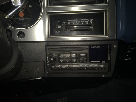

If you grab an 88-91 K5 Cluster bezel, you can neatly trim the metal dash to match the opening of the 88-91 K5/Suburbans and mount a newer style GM CD player. Or if you have the interior gutted and feel ambitious, you can swap out the metal dash sections.

gmachinz
Harnessworx Inc
Nov 10, 2012
762
303
Iowa
Jabin
You can also use the Suburban wood grain 88-91 bezels and buy the $50 LMC brushed overlay-it looks good too. I always keep extra ones cause you never know....
