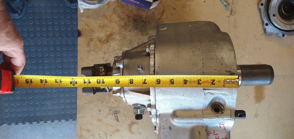

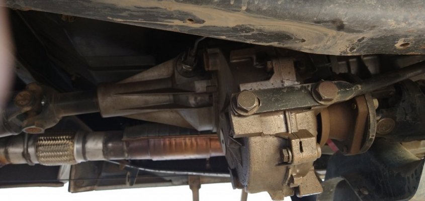

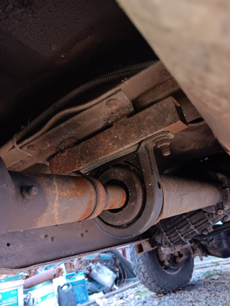

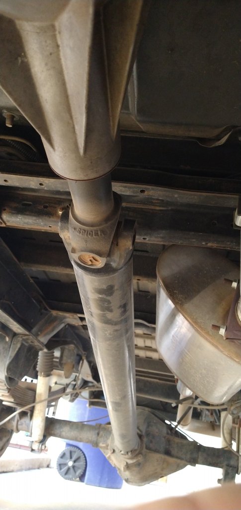

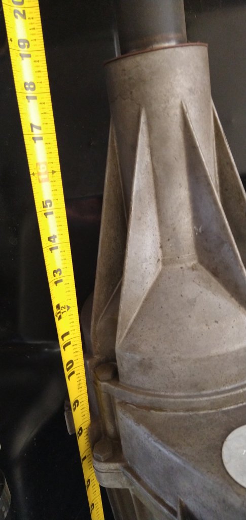

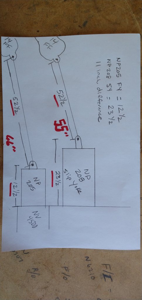

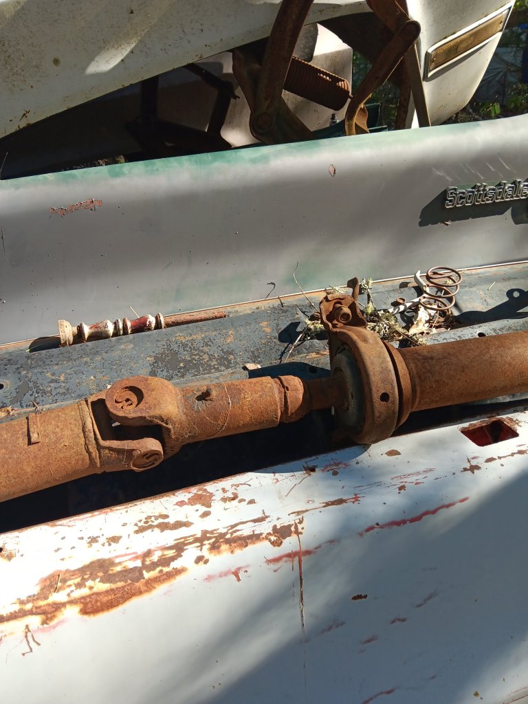

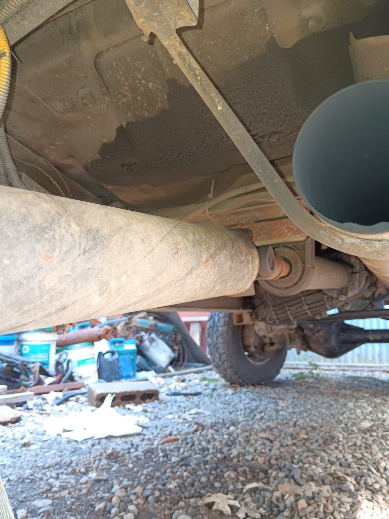

I'm about to swap my 208 tcase with slip yoke for a 205 with fixed yoke. The 205 setup is several inches shorter and therefore makes my driveline several inches short. The correct length shaft ends up being right on the edge of what's acceptable for a steel shaft. I suppose I could bite the bullet and get a custom hyper expensive 5 inch aluminum shaft but I think I'd rather just use the 2 piece setup I pulled from an 89 burb.
With that said, I'm having a hard time trying to visualize where I need to locate the carrier bearing. I doubt the underside of the burb is even close to the K series. Am I left with having to fab a crossmember to bolt the carrier bearing too?
Anybody with experience or knowledge (or PICS) of a long-bed with a 2 piece shaft?
