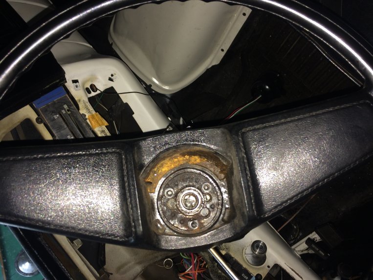

My truck had a hideous aftermarket wheel on it wen I bought it(79) I removed it and replaced it with a slightly different from stock wheel maybe from an 81-87 truck? Installed it thought it was set perfect but it's way off! As in wen front wheel are strait steering wheel is way off ... I got it on but cannot for the life of me get it back off!! I just keep bending all the steering wheel puller bolts! Wheel won't budge and to make matters worse I snapped one of in the wheel today! Any tips/tricks of getting it back off?

Can you get the snapped off bolt out first? Then go get some grade 8 or better bolts to use. Tighten up the center puller bolt but not so tight that it bends or starts to pull the bolts off then give the center puller bolt a good sharp smack with a hammer.
Alternatly you can take off the horn cup, thread the wheel nut on until the shaft is flush with the face of it. Pull up hard on the wheel and give the shaft and nut a sharp smack with the hammer.
I prefer the first option but use the second mostly in the salvage yard so I can travel without my puller.
