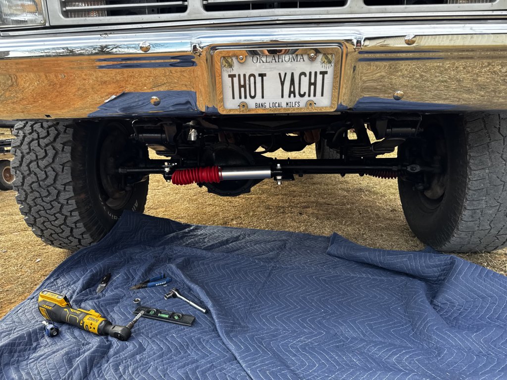

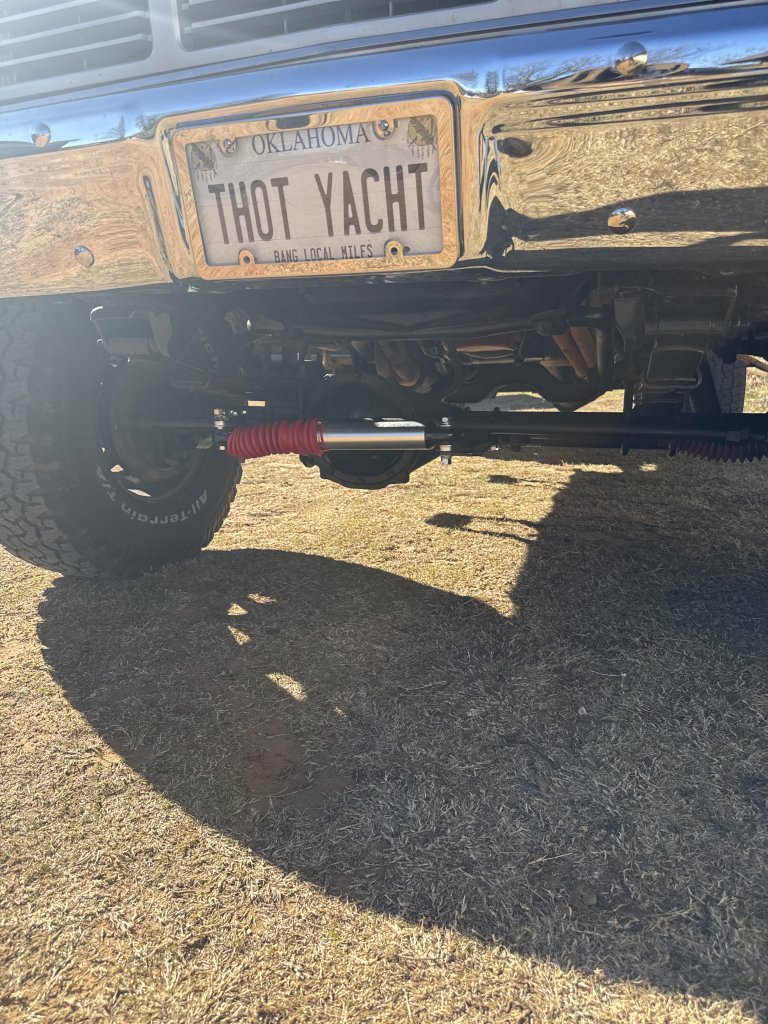

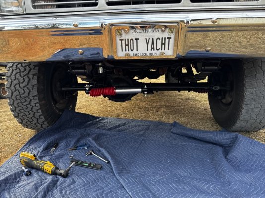

Figured I would wait in here since I’m in the middle of a dual steering stabilizer project myself.
I’m using the rough country V2 dual steering stabilizer and what I can tell you is that the shocks are made for stock ride height. Don’t ask me why changing lift and tire size makes a difference, but that’s what the rep told me.
After measuring and playing around with it, I can tell you that that steering stabilizer comes with shocks that are 23 inches when they are extended and the issue I’m running into is that they are too short and pulling my mounting hardware on the outside from one side of the leaf spring to the other, so that’s a good 6 to 8 inches of play Meaning if you get this kit, you should get shocks that are 6 to 8 inches longer in my opinion.
For now, I’m just taking the shocks off of their and leaving the mounts so if anyone has suggestions on a good brand of shock to run for the steering stabilizer and what length I am open to suggestions but right now it’s not in the budget to buy more shocks

The lift matters in my view only if you are moving your steering linkage, which you dont appear to be
Are you not using the stock bracket at all?
