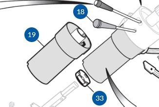

i need some advice, i have an 85 GMC Sierra Classic and the area on my steering column where the key and gear shifter is located is very loose and will shift back and forth as i am selecting my gear. the steering rod that runs through the middle does not move. Could it be the lever housing that is the problem. i have attached a picture to illustrate. thanks in advance

The key is in the upper housing and the shift lever pins in to the bowl. My guess is that the aluminum tilt housing inside the column that is held to the mast jacket by 4 bolts is moving. Not a hard job if you have the correct tools and a good guide on how it comes apart and a real task if not.

Those are a little tricky, only because actuator rod needs to be timed and several small parts that need lined up. You will need the tool to push down on the steering lock and puller to remove hinge pins. Take lots of pictures during disassembly.
Don't use the steering wheel to pull yourself into the seat. Sometimes that's the cause.
edit, will also need a steering wheel puller.
Sometimes the hinge pins can be removed without the tool. I bought the tool but didn't need it
Very true, use correct size machine screw, block of wood and side cutter but tool isn't expensive.
