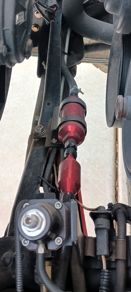

While working on the C10 yesterday I noticed not only is it cracked its got a chunk missing out of it. PO scabbed a piece to the other side. Not even welded, just bolted. Guess I'll have to fix that too.
3,723
6,737
I got the brace on mine. There's plenty of real estate around that prop valve for add ons!
