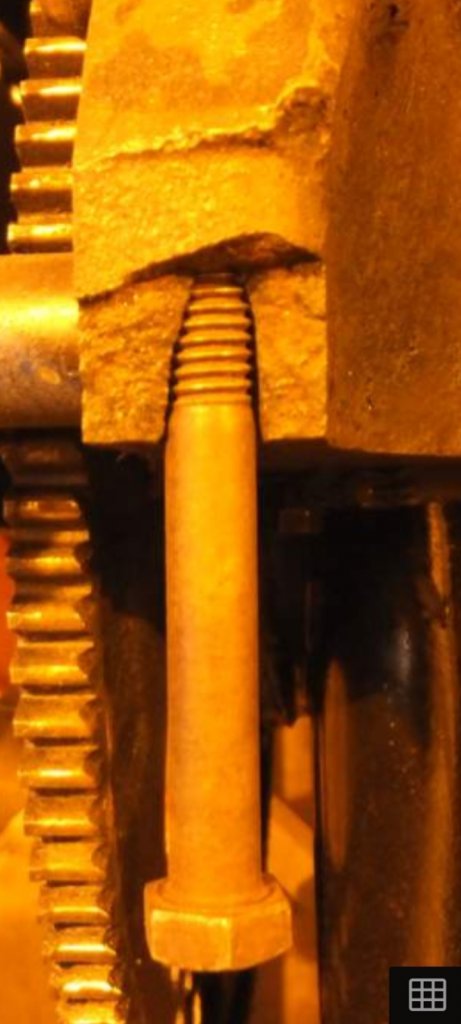

O.P. best pic I could get,braze that. Use a stud so you can replace the starter in the future. I'd still use a starter with a third mount but that's just me.

I am wondering if this is something that is able to be fixed or not?
Not really... It's a good way to buy a different block...
Dude that truck kicks azz! Welcome to the site.
Did I skip the part about the starter bracket not fitting to a vortex starter, did we cover that any?
That idea is certainly worth looking into prior to a new block because it IS valid, running a vortex unit all you gotta modify is the cable ends , it is not a bolt on mod.
Good luck - I like your truck.

Actually post 9 picture 2 is a piece made to fix this. I was just trying to save you money with a last try see if we can make it work like I did mine. In reality if what I did to mine hadn't got me buy I would build another block before I'd spend 200.00 to fix a broken one,but I can build engine.
