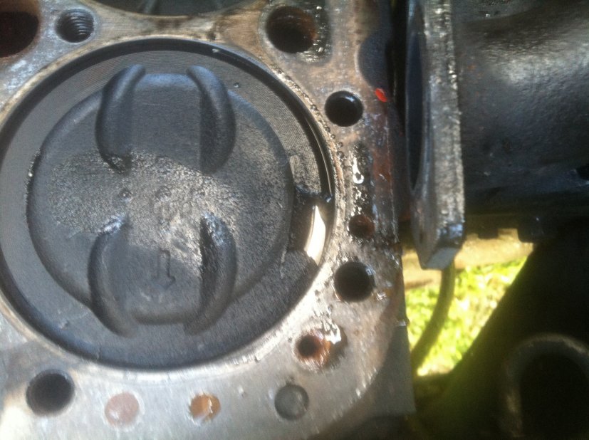

I pulled the head Found a few things. Piston # 1 had crack, valves were in need of cleaning an one head is a 191 other is 193

Feel it's been like this for a while. This is a play truck so I figure I will slap it back together and go till she blows

imho .060 over is way to much for a dependable 350. you will have problems until you replace it. obviously those aren't forged pistons. highdesertranger

GM gives a max overbore spec of .030".
I think that it is sound advice. Here is what can possibly result when bored .060 over:
