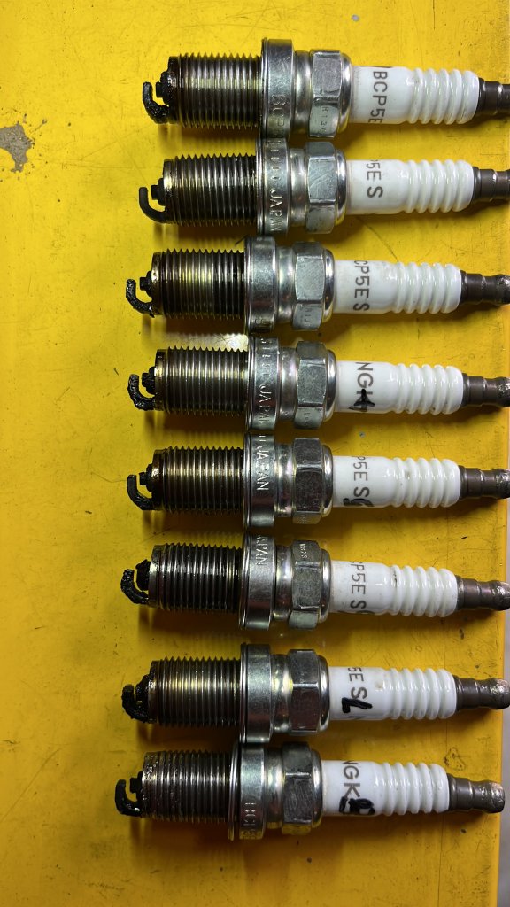

I'm after some information as to what would be causing the plugs to foul so bad and burn the tips of plug 6 & 7.

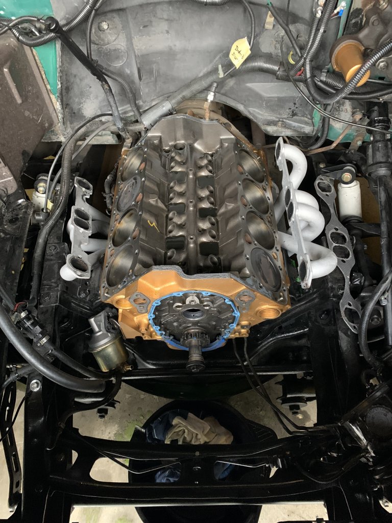

The pic without heads & rocker covers on the car is when I put the Edelbrock heads, cam and roller rockers in it

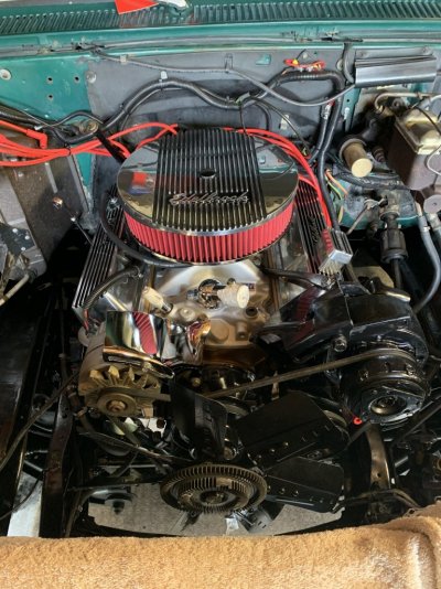

Definitely oil consumption. The compression seams a bit low but may be the variation in test gauges, or engine temp when you did the test.
Since the heads are new, I would hope it isn't valve guide seals. Personally I like Perfect Circle seals, but I'm old school. Other people may disagree.
I would move on to a cylinder leak down test. That will tell you if the rings are bad. Your engine is sucking lots of oil from somewhere. Same as a compression test, the engine should be warm for the test.

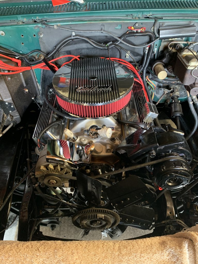

That looks to be manual choke? Also is it using the camshaft driven fuel pump, is it a edelbrock brand by chance? (edelbrock says their fuel pump can eliminate needing a regulator, which you have which is a good thing.) also, Manual trans? Auto?
The PCV situation, is your breather the opposite corner of your PCV? the PCV brand is?
Also, I just saw other photos. auto trans and regular mechanical pump. Do you know who made the pump? maybe a poor quality fuel pump, It seems to be an epidemic as of late. I only bring this up because it points to my pump pushing gas into the crankcase so I need a new pump. Does your oil smell gasy or have that "feel" which Im not really able to describe, but anyone whos drained out gasy oil and ever felt it compared to just old oil maybe would understand what Im saying?

lastly about that choke, are you diligent about setting it and opening it appropiately? Not forgetting? Just something to think about
whats your valve cover look like? Baffled by the pcv? And you said 2k kilometers on your new engine, sounds.... kinda simple, but did you break the engine in the proper procedure/oil/drive the appropiate way to the directions and then also what kind of oil are you using?
also dry PCV hose? Not even oil vapor that you could see? Unless you were running the cleanest catch can setup vehicle ive ever seen I feel like oil vapor/small amount of oil or atl east wetness should be in the hose, but it depends on how long you were using it. If youre burning that much oil, Id kinda expect oil for sure. Is your PCV caked in oil or dry itself?

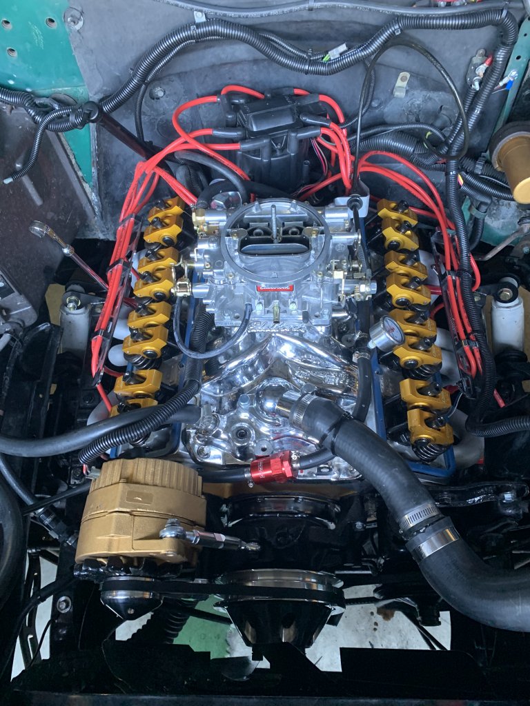

This is the motor assembled prior to me putting the new heads and cam in, showing breathers etc.
