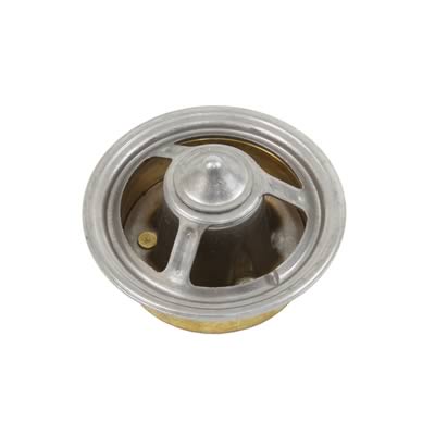

I am using a 195 degree high flow thermostat (Robert Shaw, IIRC) and it works very well to keep the engine at about 190-195. It already has a drilled bypass hole, and it’s designed to provide a larger opening to help flow. I am also using a high flow cast iron water pump.
Thermostat arrived yesterday! Thank you!
