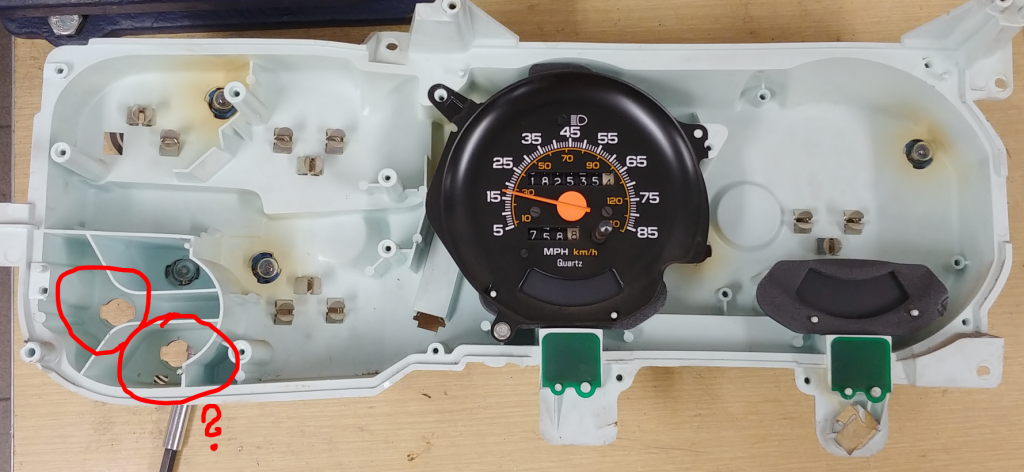

I'm in a middle of what I though will be a quick gauge bulb change that ended up being dashboard disassembled, checking gauges, cleaning and troubleshooting. All thanks to those odd (for me) bulbs that look like regular W5W or W3W, but are integrated into plastic sockets that need to be pulled from behind. Couple of questions that I have:
-How to remove speedometer from gauge cluster? I have electric speedo that connects to flexible circuit board, but I can't figure out how I suppose to unclip it from that board wothout ripping it
-Anyone had a problem with a trip meter not resetting? Mine doesn't react to the button
-Is it normal that I have a provison for a seatbelt warning, including a bulb, but looks like I doesn't have that feature? Not that I miss it
-I have only a battery warning, but there are two more provisions for idiot lights, what are they for? No bulbs and no cutouts in a screen so I have no clue.
-Is there a way to adjust speedometer? I have bigger wheels so my 55 mph is actually around 62 mph.
Things that I've already discovered:
-If your voltmeter reads too low you can add a resistor between "+" and that unused pin, parallel to the ceramic resistor. Mine needed if I recall correct 1000 ohm to make it point to "8" at 8 V, "13" at 13V and "18" at... 17V. I can live with that instead of 10 - 11 V when it's charging 13.5 V
-There is 0.2 V less on a voltmeter pins than on a battery, which skews volt reading a bit
-I didn't know that 700R4 came also with electric speedo
Oh and some engineer needs a proper slap for making those bulb sockets NOT ACCEPT regular W5W/W3W even if you rip the bulb off from that plastic. "Replace whole assy" my...
