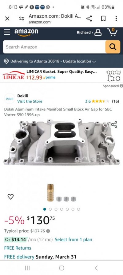

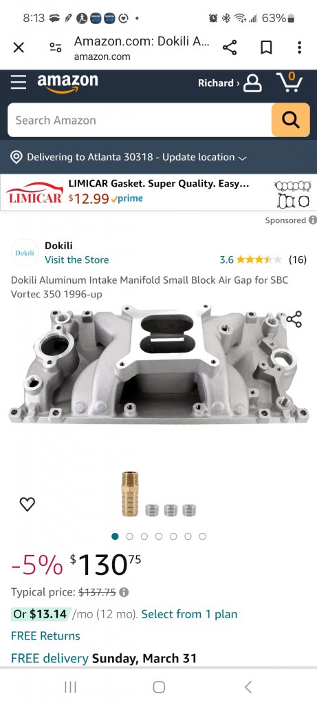

Personally I'd run it in factory location( cylinder head ) ps. you don't put temp senders in an intake port. Any ways there are so many SBCs running around with headers,never once have I heard of it throwing a gauge off,but readings in the head will be higher due to closer to combustion chamber. I want to check the hottest spot not some meh spot. If you are concerned about it see if your manifold is,or can be drilled for 4 corner cooling. Matter of fact I'd be more interested in doing 4 corner cooling than worrying about gauge sender location. Manifold with four corner cooling pictured. I'll try to find a pic of one plumbed. Too many pics to choose from, Google SBC 4 corner cooling plumbing pics.
