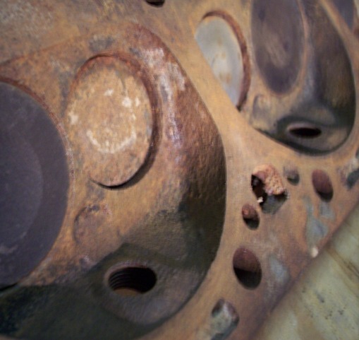

Not all early 70's heads had hardened seats. I had a set of heads that were damaged as a result of unleaded fuel and IIRC, they were 73 Julian Dated heads.
Apparently they started installing hardened seats in 71' and still had non hardened seats up to 73' But anything 74' and up should have hardened seats from the factory.
