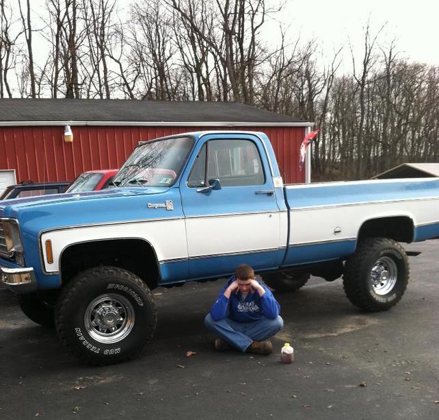

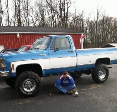

Then my consider taking outcher springs and put in railroad track instead. That way the truck can't flex and rub your tires and chew them up. :rofl: If your're going to wheel hard, you're going to have to have some space for flex and the springs to function and do their job. But 35's with 6in look good. I'll look in my folder and see if I can find some 35in and 6in truck pics. I've saved some with different configurations for when I decide what I'm going with.
47,210
9,483
These 2 are 6in 35in Tires. The Dark Blue is Vals truck if not mistaken. I don't have any pics of 4in lift 35in tires. Sorry. Just some 4in with 33's.

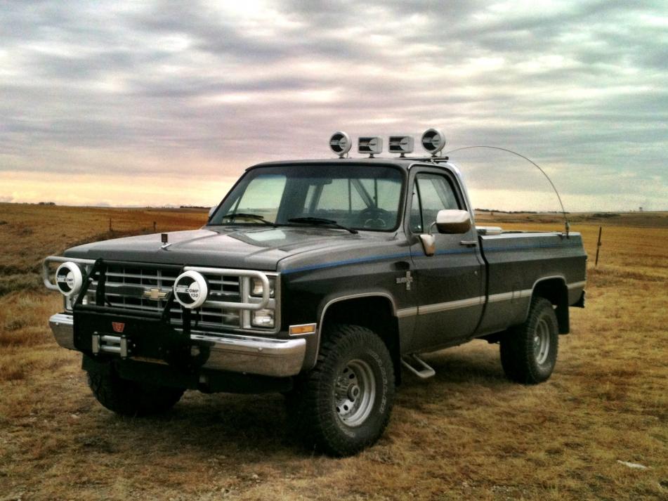

This is a 4" lift with 35's.

Ummmm.... I know the tires are 12.5's, but I know nothing about the wheels. Not my truck, sorry.

That doesn't look bad at all, but again, not much room for flexing. Could just trim the lower portions of the fender though and looks like it would be fine. If you're not planning on deep water lower COG is certainly better.

I think it LOOKS about perfect, as far as the stance goes. But as far as function goes, that would need to be experienced to know if it will work for your individual purposes. The front tires look like they want to take a bite out of the front fenders the first time you put it through it's paces. But I have also seen cases that I was sure they would need to be trimmed, and they ended up clearing by more than one would have thought. If it were mine, I would be doing some range of motion testing and cutting the absolute bare minimum needed.
