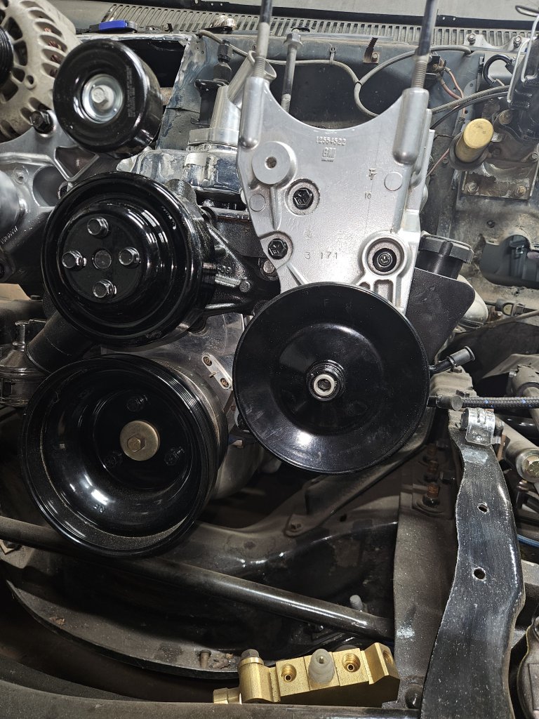

Got the power steering pump installed, and pulley on. Clearance the bracket. Powder coated the water pump pulley. Ordered some ARP water pump pulley bolts, and water pump bolts...

All of this serpentine stuff is all new to me. I'm a V belt kind of guy... who says you can't teach an old dog new tricks...

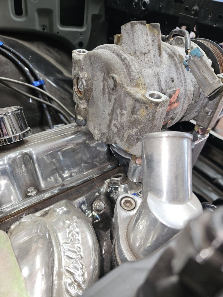

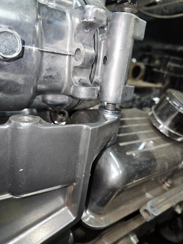

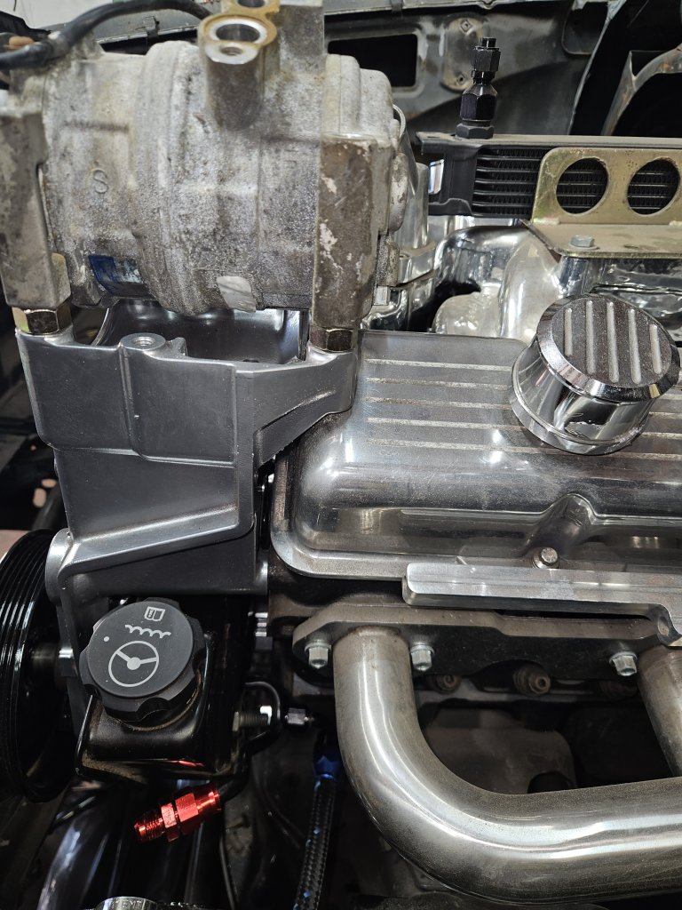

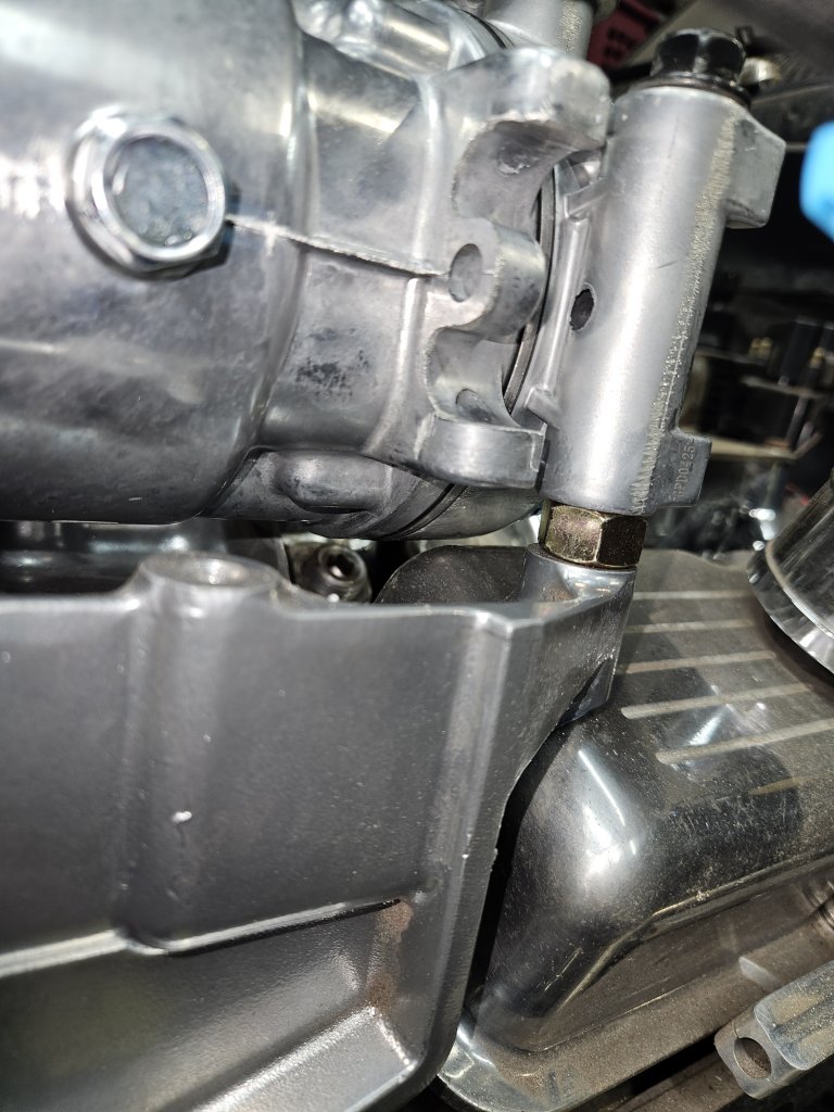

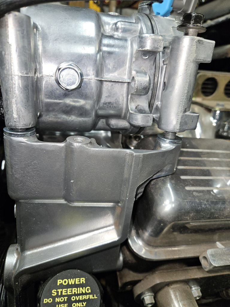

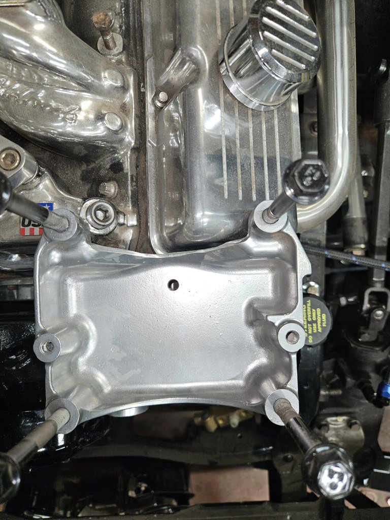

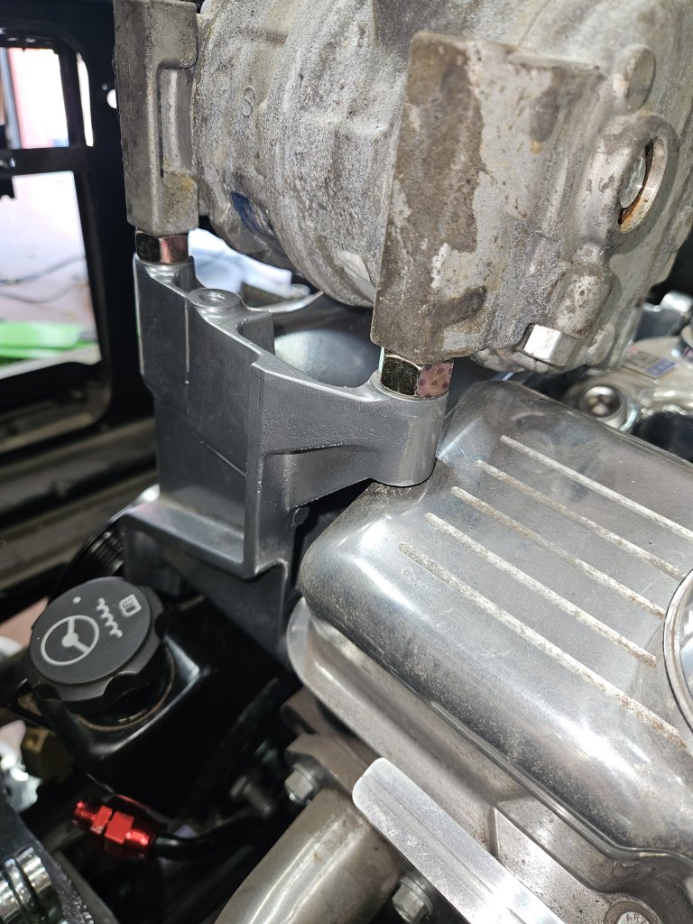

Got the AC compressor today, same problem needs to be shimmed to clear the valves cover. Might go see it I can find something that doesn't look like a nut.

Your covers must be petty tall then. Keep an eye on your tensioner travel, that might require a belt the next size up.
If you have a good hardware store look for a shaft collar maybe, or some round stock if you have a good drill press.
i was gonna say, having the diameter of the threaded portion being just large enough to allow it over the bolt with minimal play is probably smart.. also, id be taking into account how much of the threaded portion of the bolt is actually going into the bracket. its threaded aluminum. if its not enough engagement, you need to either put threads in (Heli-coil type stuff) or using a deeper bolt is best...
That ,if you could find a new bolt of perfect length and a shoulder thats not threaded.. at the collar/spacer spot.. would be cool but probably not to be found without a custom bolt created

I was going to run up to my local hardware store and see what they have. I'm sure they have some sort of spacer. My valve covers are not that much taller than stock, they just don't angle down on the ends. I'm going to order my alternator today. I'm just going to get new so I don't have to deal with sending back a core.
Yes longer bolts are going to be a must. about 3 maybe 4 threads engage. I might get longer than what I need and trim it to fit correctly.
