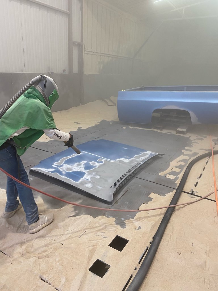

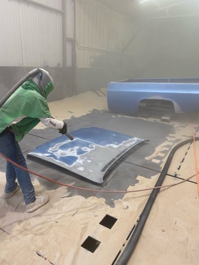

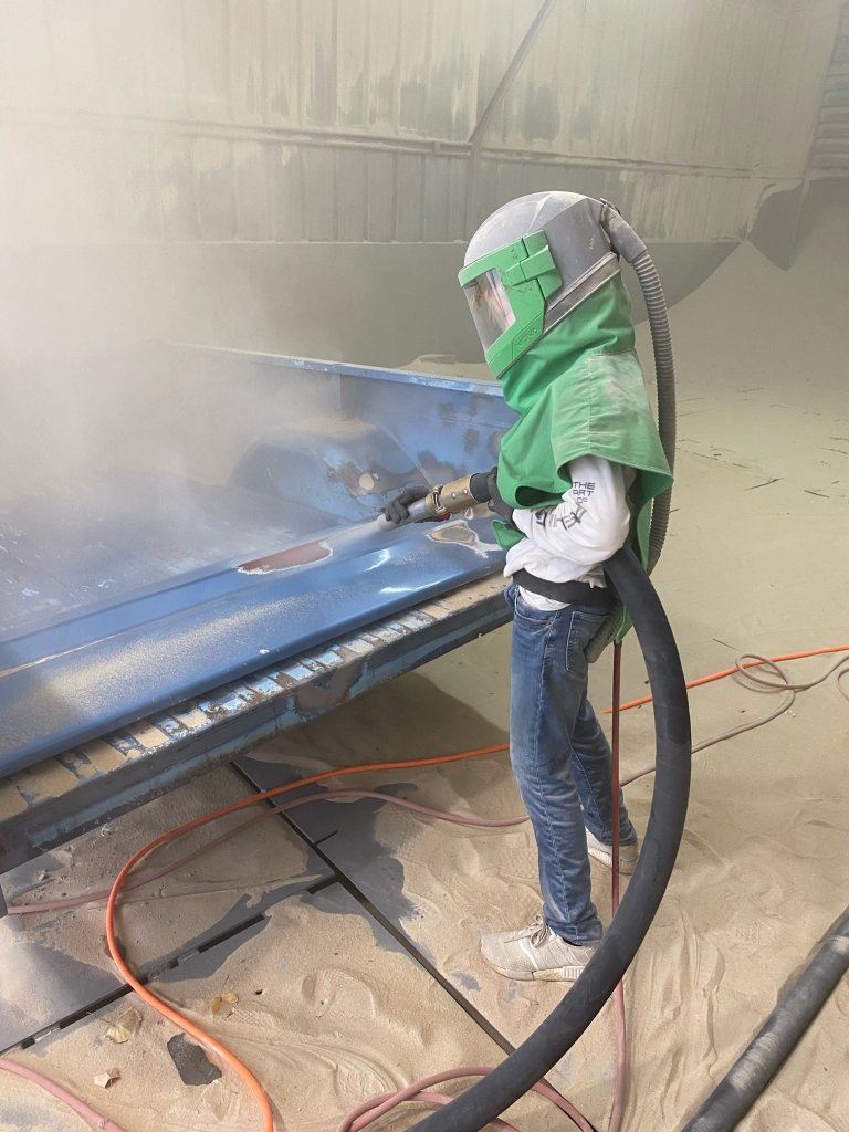

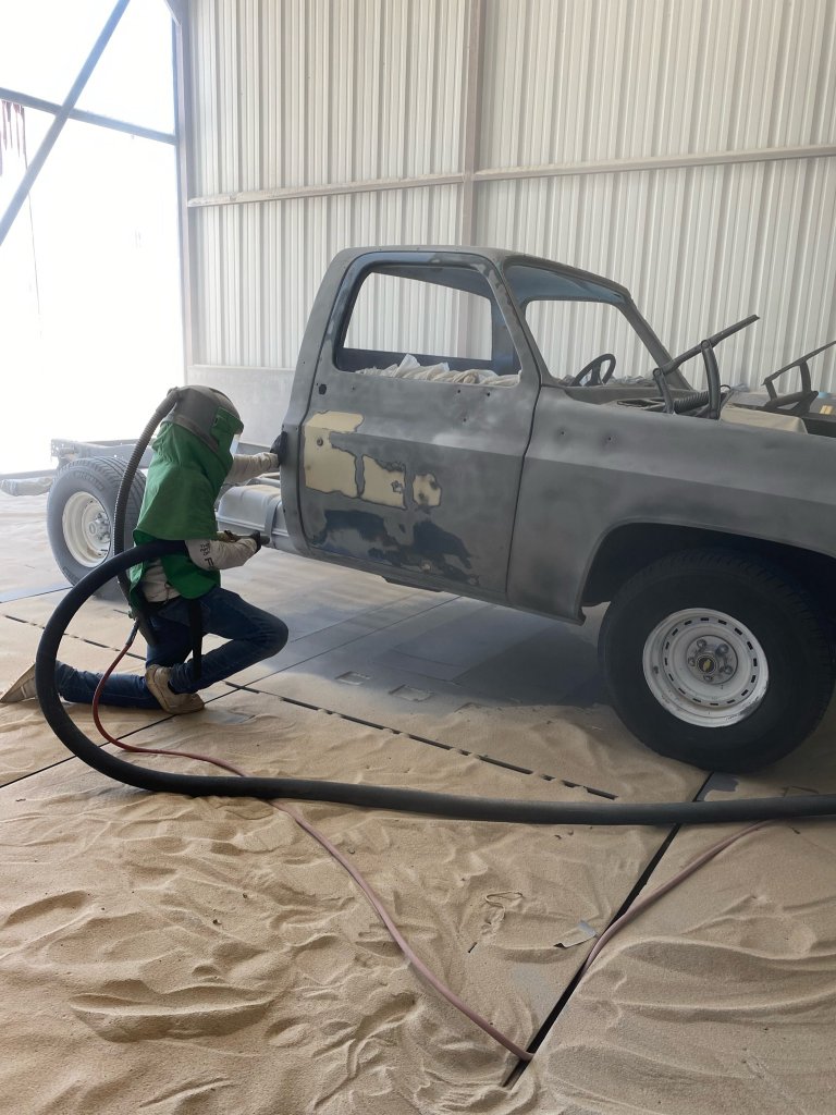

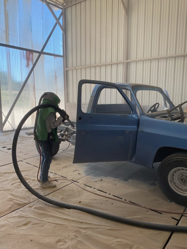

we sandblasted ours.. it’s work, but nothing gets missed. That said, I’ll bet your method will be acceptable. Post some pics of the process.

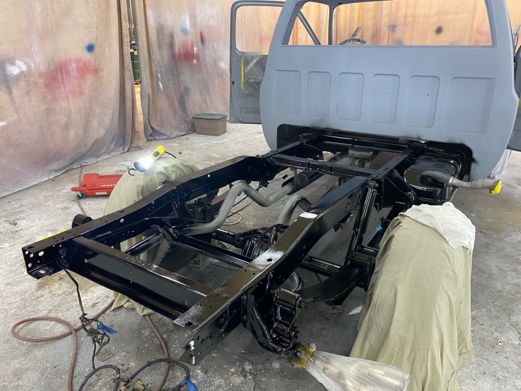

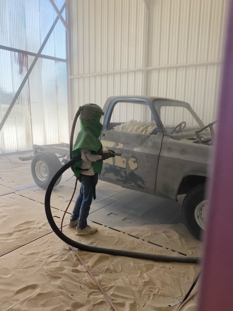

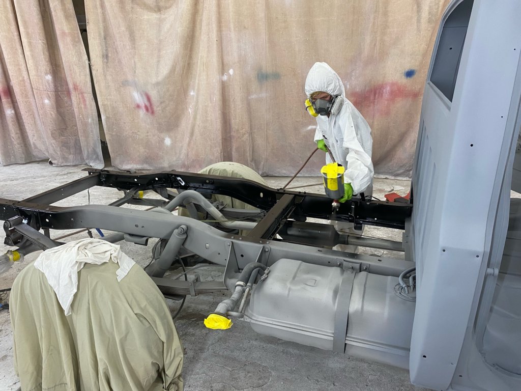

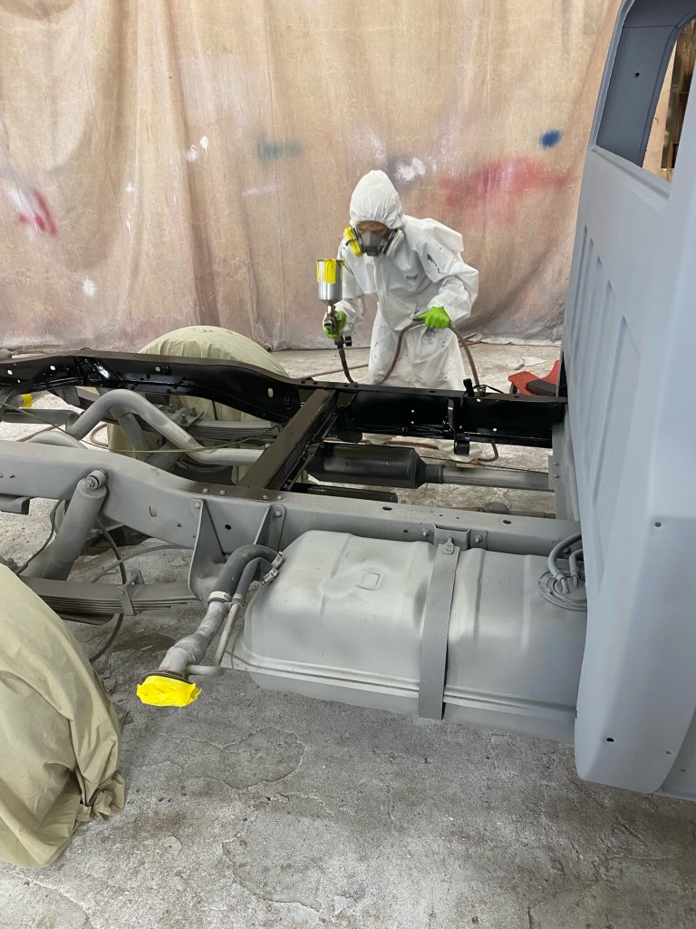

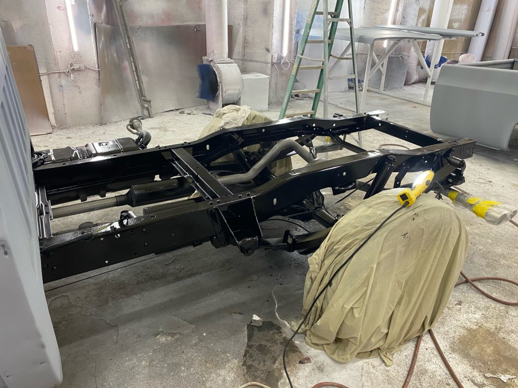

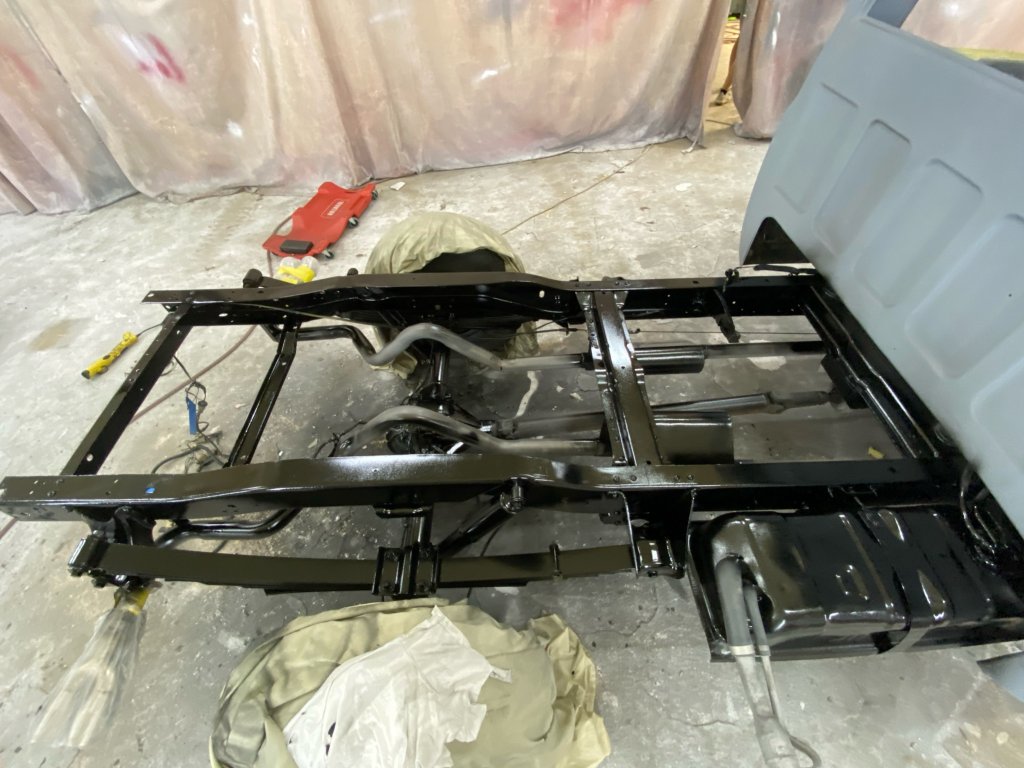

Easton’s uncle owns a sandblasting business about 30 minutes away so I figure these are good life lessons for a 14 year old to learn. He blasted, primed, painted and rebuilt it in about 8 months, little help from dad but his truck, his budget and his sweat.. nothing like sandblasting in Texas when it’s 100 degrees.
