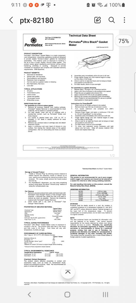

The fairly vague instructions say apply 1/8" bead of silicon and preferably let sit over night, I'm assuming this means before you bolt them to your heads ?
6,453
10,984
Use your ultra black as designed by permetx which from memory is permetex,then finger tight install. Wait 1 hour,tighten,then wait over night.
Got the instructions off the p tex website for you attached below
