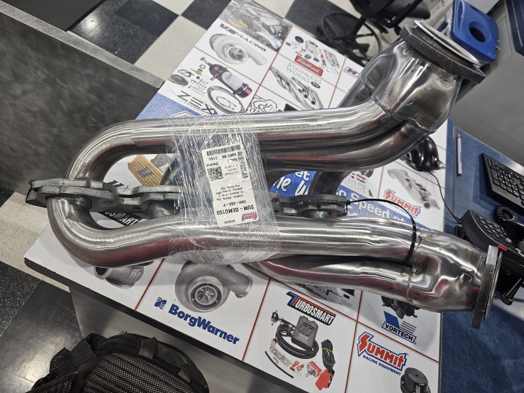

I have bought $486 worth of headers at Summit Racing for $150. Is anyone using Sanderson BB8-P big block headers on your truck. I'd like to see pictures please. Do you guys have starter or oil filter clearance issues? The truck has a factory engine oil cooler. Tia.

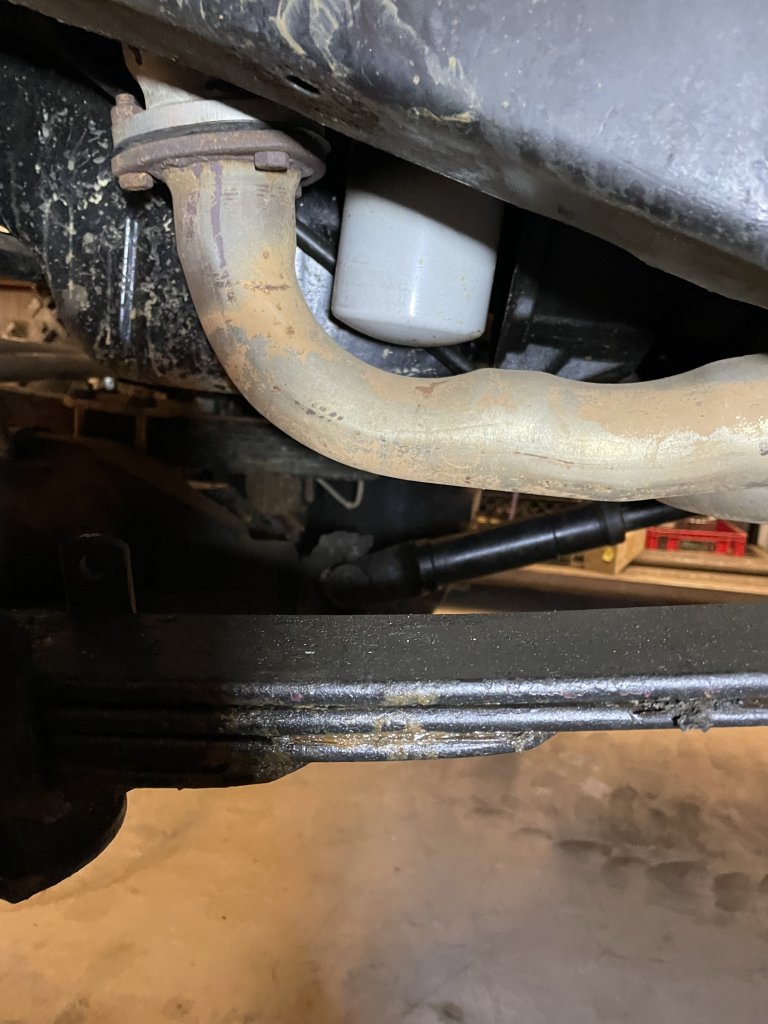

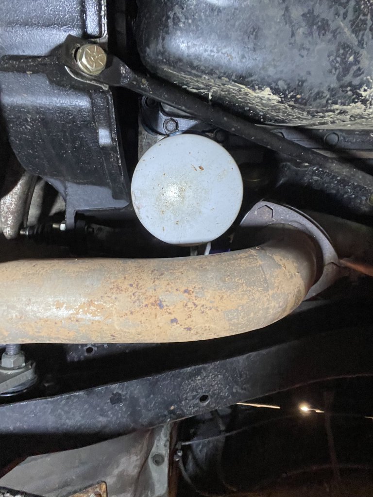

It might be hard to tell but there about 1/2” clearance between the collector and filter.
