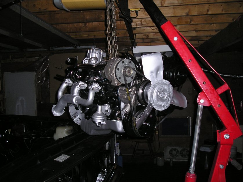

Jerry, I can't see the pics here at work but I saw them yesterday on my phone. What kind of exhaust manifolds are on that engine? Are those a factory header?

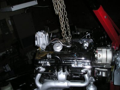

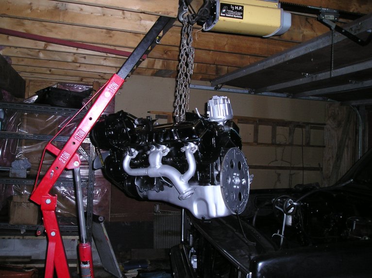

Those are the factory exhaust manifolds that come standard on a 85-86 C/K truck equipped with the federal heavy duty emissions package and with a 350 engine. I think they are also used on all big blocks of those years.
They are constructed of shaped/welded stainless steel tubing. Also have threaded bosses welded into the individual runners to accept the A.I.R. system's injection pipes.
The ones in the images were painted with Dupli-Color's Flameproof product. It's a ceramic based VHT coating that - with proper prep and application - withstands temps up to 2000 F.
