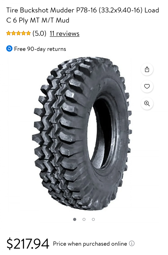

Y'all recon these tires will fit the stock rims ok?

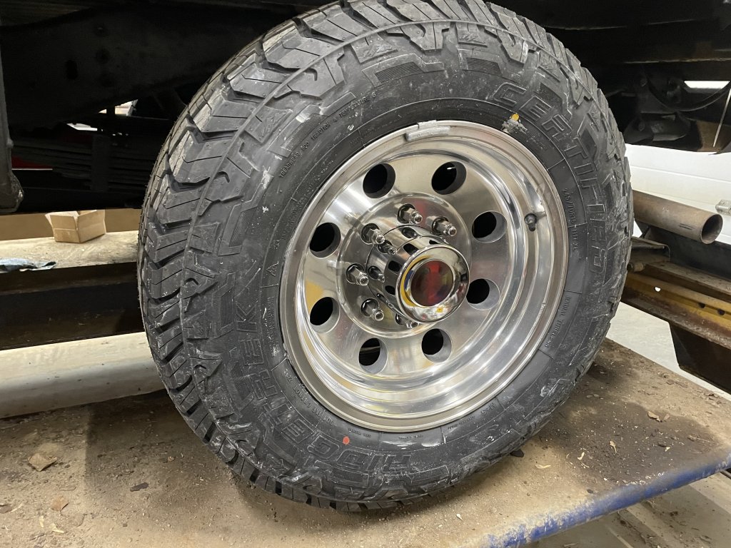

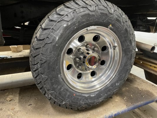

Here are the notes from my trie/wheel hunting. I also had the 16.5 rims and wanted to keep the steel rims to run the dog-dish hubcaps. One of my coworkers has an almost unhealthy Dodge addiction and was going to give me a set of steelies from his piles. He found the aluminum there and sold the set to me for a "song and dance." I spent an hour or so polishing each rim (over a few evenings), and I'm happy with the result. I got cheap rubber from my local Canadian Tire. They had them in stock, and I got the rubber mounted on the rims before I was out of my doctor's appointment.
16" Wheel (-0.5" from original)
  • Wheel 16 in x 8 in at Cdn Tire
  • Bolt Pattern, 8 x 6.5" (165.1 mm)
17" Wheel (+0.5" from original)
  • Wheel 17 in x 9 in at Cdn Tire
Optional donors:
  • 2007-2014 STEEL EXPRESS 2500 VAN 16 x 6.5J, 8 BOLTS WHEEL
  • GMC Sierra 2500HD (1999-2010)
  • Chevrolet Silverado 2500 HD [2001-2010]
  • CHEVROLET SILVERADO 2500HD / 3500HD (SRW) 2007-2010
  • Dodge 2500-3500?
Tire information:
  • Original size 8.75R16.5LT
    • Circ: 92.6"
    • Dia. 29.5"
    • Width: 8.8"
  • Tires purchased on April 22, 2024
    • Close to original - 245/70R16
    • Dia. 29.5"
    • Width: 9.6"
