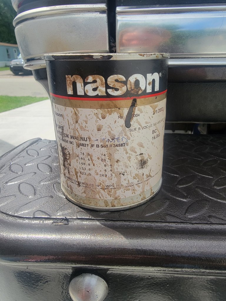

Bumper paint is actually dark metallic brown, I found can behind seat for that :) Wish he'd have left more clues to body paint.

That paint from what I can read on the can is base coat. IE should be clear over it.
Is it just the bumper paint or is the bumper same color as the truck?

On looking at your picture of the paint can zoomed in now, it looks like bumper color and not truck color.

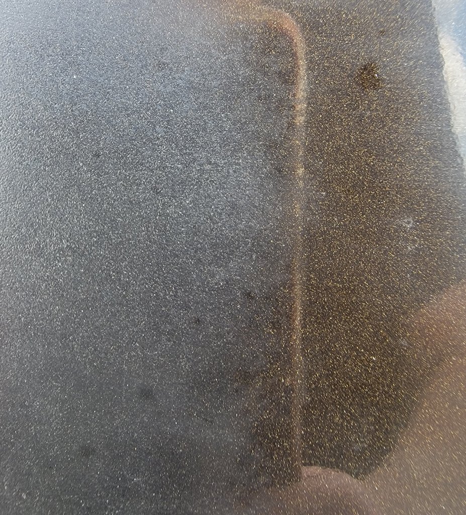

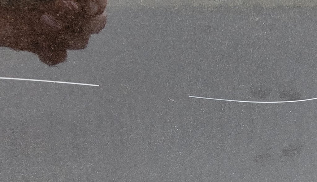

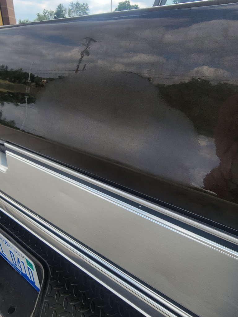

Actually, I'm starting to really wonder! Bumper is dark brown, but spots that I assumed was spray can/ bedliner overspray on the body do have the same look??? Minus a clear coat? Maybe guy just got 1 can and went to town? It does have flecks of same color as paint. Really hard to capture, especially on bright day. If that turned out to be true it'd *really* make my day. Then wouldn't matter what shop, just need to order sample and hand to them.

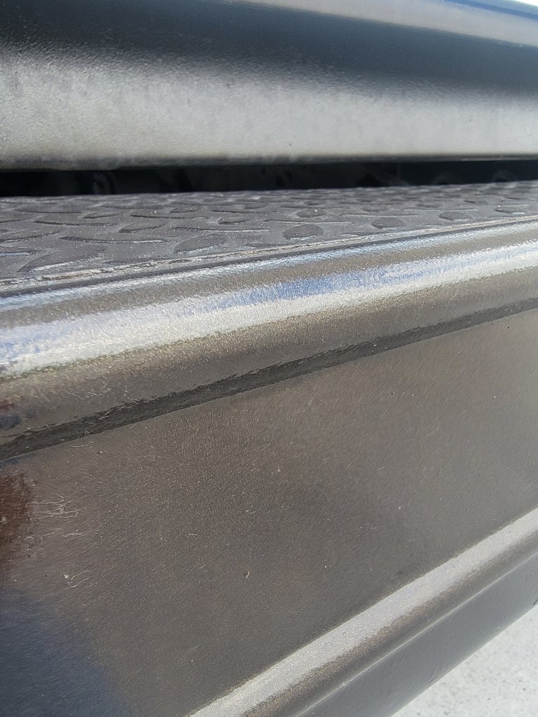

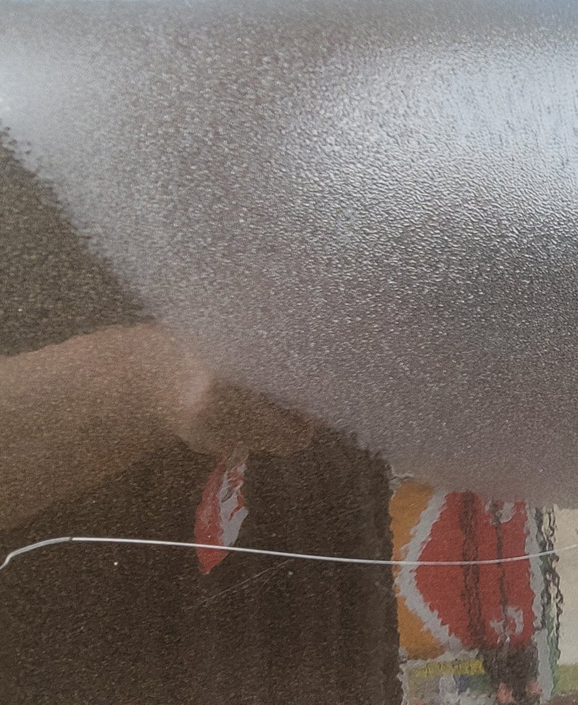

Bumper also has flecks, awful similar if not exact.

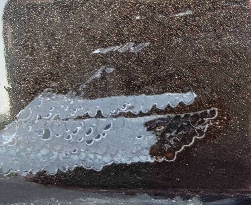

Can see through to the line looking straight on, not on angle though. had the tiniest thinnest amount in very bottom of can. I wetted a q tip and applied. I was looking at scuff, dent and parts not through to metal do have white powdering. So must be clear coat!

From your pics, yes it looks like clear coat/2stage paint.
80s trucks were single stage Paint. So yes it’s been repainted as you found. And it sure looks like the right color.
You may have solved the mystery.
And if that bedside is base/clear, it’s a much more straightforward repair to blend.
One word of caution, you don’t know how thick the existing clear is.
Judging by the quality of the paint job I’d hedge on the side of caution. However it’s a piece of cake to scuff the whole bed side, do the repair, feather out the base coat around the repair and then just clear the whole panel.
Only downside is it may be a lot more shiny than the rest of the truck.
But you can lightly wet sand the truck and cut and polish to get a more consistent appearance.
JMO from the pics you’ve provided and my assumptions.
