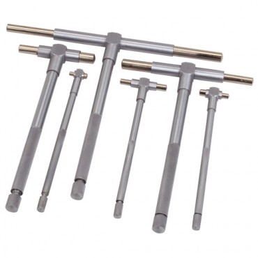

When you mic it for out-of-round check cross ways (parallel & perpendicular to the crank) at 3 positions in the jug...
attachment.php
If your "1's" and "2's" vary by more than 0.004" it is borderline time to be bored.
Using the same chart for out-of-taper, if your A's B's and C's vary by more than 0.004" it is borderline time to bore. You also have to keep in mind the wear on the pistons, when you measure them for the same specs and add that to the specs of the jugs you can see how a fresh build can end up with piston slap by the 10k mile mark.
Telescopic gauges, i.e. snap gauges aren't very expensive but it's even better if you can borrow a set lol...
attachment.php
I take a notepad and keep track of all the measurements, dedicate a whole page to the measurement of each cylinder so things dont get mixed up. Hope you dont think I doubt your abilities, I like to put stuff like this out there for everyone. Good luck and post back your progress!

I took the measurements using a micrometer made for mearuring inner diameters (not sure what its called), similar to one that's used on od's like rod and main journals.
Inside micrometer:
Or maybe a vernier caliper:
hootsmcgoots
Sep 1, 2012
58
Norton, VA
Jason
305/SM465
Inside micrometer:
It was an inside micrometer. Veneer calipers are OK, but not as accurate as micrometers IMO.
