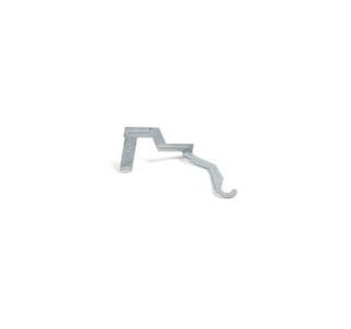

When the cap is apart make sure the ground strap is there. Also look closely at the 2 wires coming out of the pickup coil. Occasionally they will break at the coil and cause the motor to die or misfire.
if it uses one that style of course. thats a 75 change i think
Yes, that's right the later HEI units did not have that style of ground strap. I'd have to go look up the details on that to get really technical but the main thing is if it has a ground strap it needs to be intact and functional.
