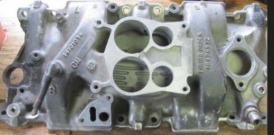

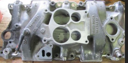

I haven't had a chance to get any pictures of the carbs yet but I found this for a cheap price and its aluminum. I know its not a Edelbrock intake like a performer but I didn't feel like spending a whack of money on a intake. This is still an aluminum intake for the quadrajet.
Cheap??? Not wanting to spend a whack of money on an Intake? Bud, you might check into it, but that might just be a gold mine and be more valuable than a Performer. Not sure if that's one of them, but a facorty GM Aluminum intake usually means Whack Money. That could very well be off a Vette, or Z28 camaro or some other performance engine that a guy restoring a car will pay good money for. Hell without even looking it up to see the value, I woudln't mind having it, and if it's indeed a useable one and not fugged up, I'd be willing to trade a used Performer for it.
Edit: Oh now I paid attention and see the EGR port. That'll make it not one of the valuable ones for sure, but still very worthy of using.
47,210
9,482
From what I see it's not a valuable one. If the info is incorrect it appears to be for 82-92 Caprice and Camaro on 305 and 350 engines. Seems it has ask prices of $80-$150 depending on condition. That's the ask price though, doesn't mean it sold. I'd still use it though. Lighter and discipate heat better for sure.
