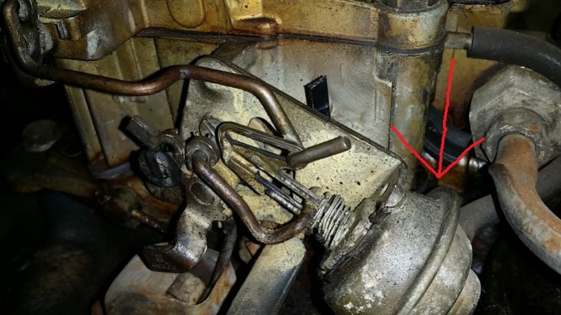

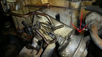

So I have not been able to start my C30 in a while I thought it was the module for my HEI AND @RetroC10Sport help me replace it and it didn't start either. The other day I remove the rod that make the choke open and close so I could set the choke to the close position but I didn't succeeded either.
I did notice some kind of build up on the left side of the carburetor, and when moving the secondary plate by hand I notice that the spring next to the choke valve was not moving.
I know nothing about carburetors but I thought I would ask if I get a carb cleaner and replace this choke valve thing could I get it to start.
Oh I really don't know what that zip tie is holding together it was there when I bought the truck.
Or I will be better just getting a new carburetor.
These are pics of what I see.

What is up with the pull off canister on the passenger right side? It looks like its broken or has some wire wrapped around it?
Can you move the plunger for the pull off freely?
Are you talking about that?
Yes that part.

That's how it was when we remove plate and bowl to get to it. the spring that connectos to the pull off is completely stuck when I pull back to open the secondaries it didn't move at all.
Well that is the choke pull off canister. The long part behind it SHOULD push into the canister freely. If this does not happen then something in that area is causing it to bind.
I would start in removing the pull off and freeing the linkages and go from tehre.
I should be able to use the carburetor cleaner to get things moving or should I just do it dry as it is?
Everything should move freely without needing carb cleaner. And if you are going to do a rebuild then get a good degreaser to clean up everything.

I will try too get tip it after work.
I don't know what that zip tie is there and what is holding.it cpuld be the pull off canister but not sure
