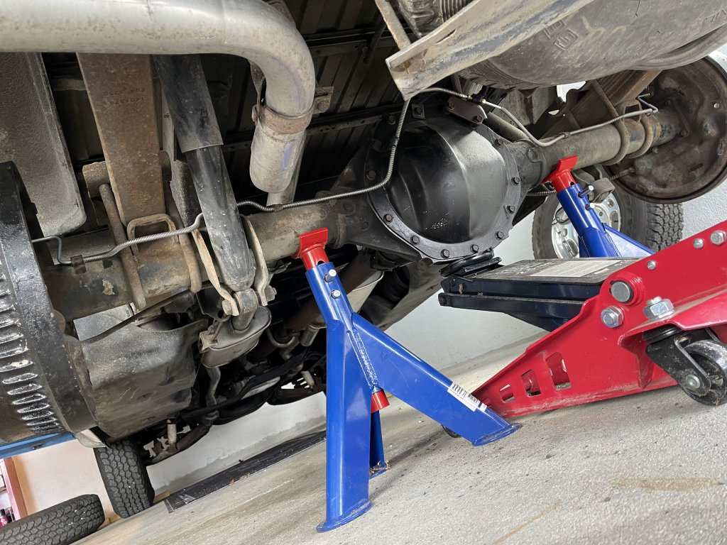

Bled all the brakes and everything seemed fine. Jacked up the rear end and pushed the brake pedal - no rear brakes at all. I can spin the wheels by hand. Front brakes work good and parking brake works. I adjusted the shoes outwards as much as i could, but that ended up with one rear wheel overheating, and still no braking power. Now im not sure if I ever had rear brakes the 3 years i`ve had the truck….

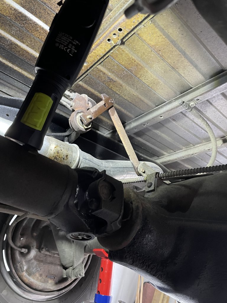

Disconnected the lever at the LSV and tried moving the little switch all different positions, but no changes. I can hear and feel some sort of piston inside moving when i spin it around.

Bleed them some more. Neither of those valves will make the brake pedal go to the floor.
The load sensing valve is an extra proportioning valve with a on/off switch. It's either proportioning, or it's not depending on ride height.
I hope you made a note of the position of the shaft in relation to the lever before you took it off and moved it.

I did take notice, as there were a little sticker on it, but it seems like this spins freely with maybe two positions.
Plan was maybe to delete the whole load sensing valve.

The installation was based on dimensions. That little plastic tab on the shaft was actually a sacrificial install tool. The tab was aligned with the arm, then broken off when things moved.
Basically there's a cam that the shaft moves that either allows the valve to move with brake application or not. The cam is spring driven so if the valve moved and the suspension traveled further it wouldn't break the follower off the valve. If you look at my pic in the thread I linked you can see what it all looks like.

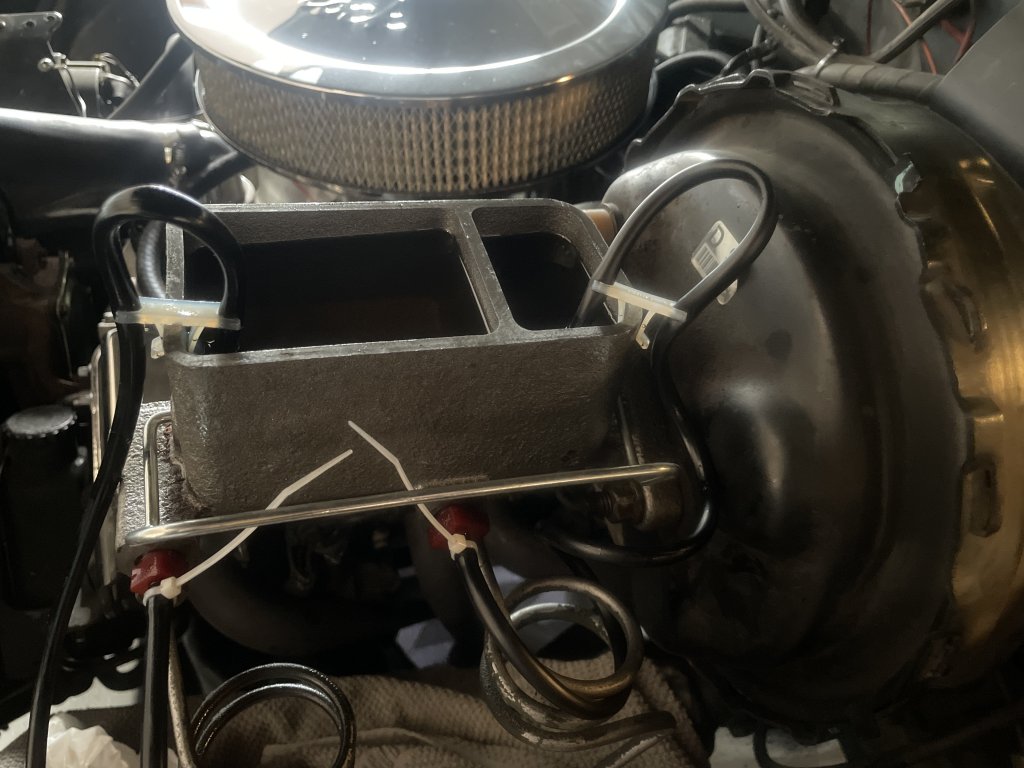

Well, I started from scratch again and bled all the brakes. I managed to get the rear brakes working again, but still a huge amount of air in the system. I noticed a little «volcano» erupting in the front reservoir in the master cylinder when i pressed the brake pedal. I disconnected the lines from the master cylinder (which I bench bled and installed last year). Started bench bleading this in the car and the air does not stop bubbeling. I have pedaled for over an hour also tapping lightly with a rubber mallet in between and still bubbles. Can a defective seal or o-ring in the MC introduce air in the system? Only the front reservoir is bubbeling, not the rear.
