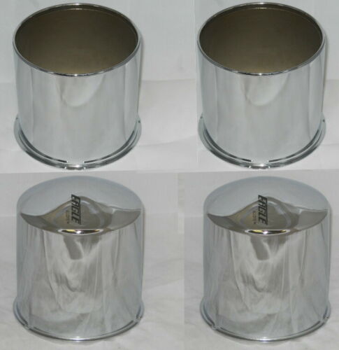

I am not sure of the inside diameter of your wheel but 4.25" is somewhat standard, please verify before searching. I ordered a pair from Jeg's for my k10 aftermarket wheels but can't find them on their site now but here are two other retailers. They often come either chrome or stainless, I opt for the stainless because the chrome ones often pit real bad quickly in the elements.

To add to the previous post, the center bore of the Pro Comp wheel is 5.15." That is the same as my American Racing Baja's. Any Metal cap that size should work.
