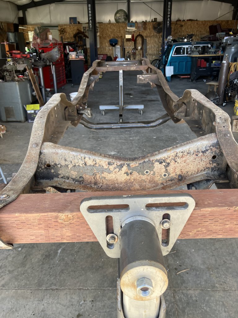

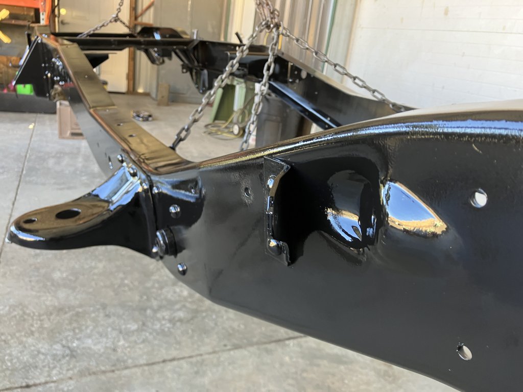

Magnet paints chassis saver. But my true belief is the acid wash is the magic,not the topcoat,I wash with a water based cleaner( same as por 15 marine clean) I wash with phosphoric acid,I use Ospho,( same as por15 marine clean) I top with whatever I want. The phosphoric acid stopped the rust,( or you can top coat with por15. Do some research on phosphoric acid as metal prep. I believe Por15 took an old 3 step system and relabeled it as new magic,look at this new magic paint,don't look at the science, the metal prep and what's really happening.
Magnet over epoxy primer. Like Ricko said, prep is 90%. I used zep, pressure washer, grinder, lacquer thinner, acid etch, primer, paint. Also clear coat would keep it nice forever. Cost to do the work, materials, consumables, paint was about 800.00. took about forty hours.
That cost a lot of time and money but, dang, that looks great in the end!
