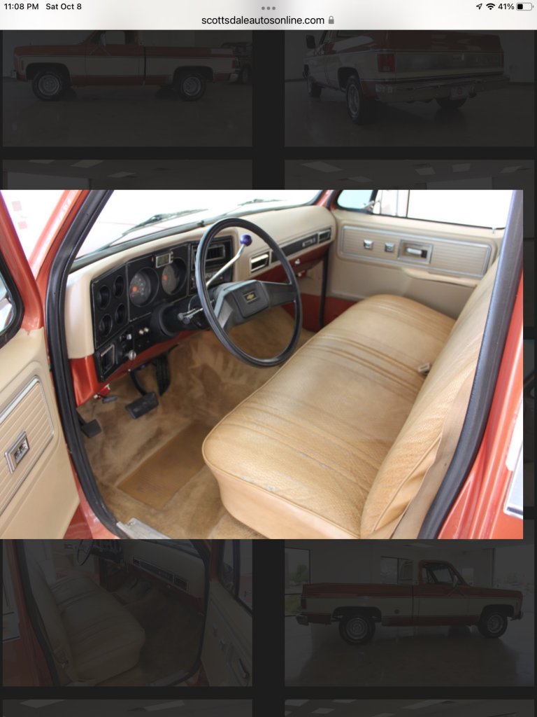

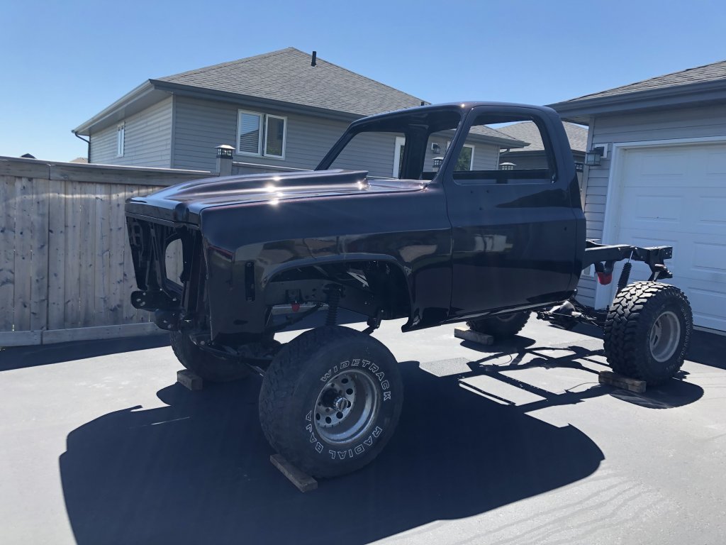

I recall reading about someone on here painting a dash pad. What kind of paint did you use? I want to do the interior of my truck in light buckskin or tan but all the dashes are darker or brown. I want the dash the light colour too as seen in the pic below. Also attached a pic of the rig under construction.

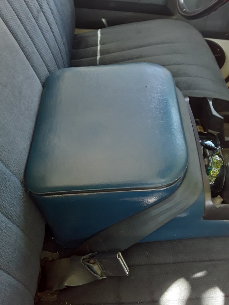

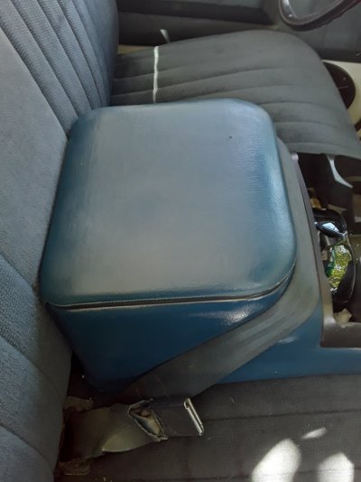

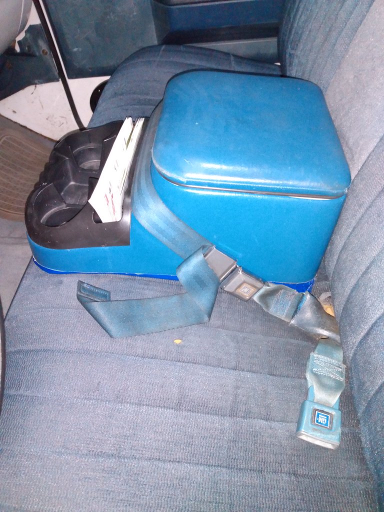

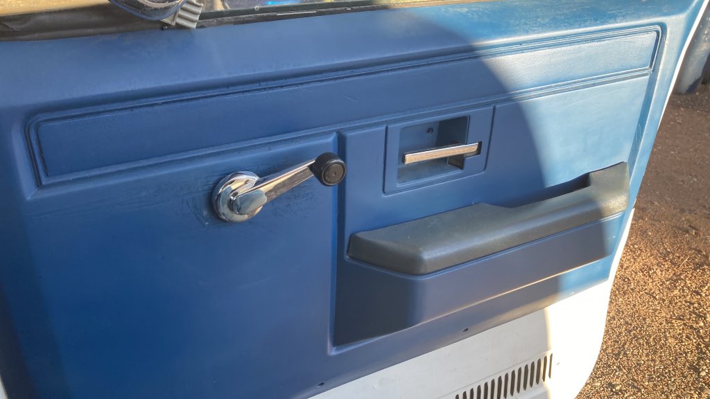

I used Krylon Fusion paint on my door panels and dash pad. My dash pad is trashed anyways and it's covered with a dash mat. Also did my console, which was originally tan.

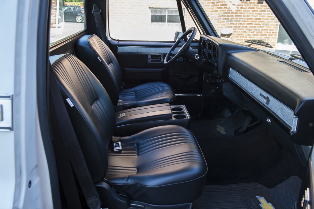

use SEM paint work great...but the secret is...preparation good sanding,cleaning, use of good adesive primer ect... ;)
in this picture a did door panel, console and all the trim and dash ;)
