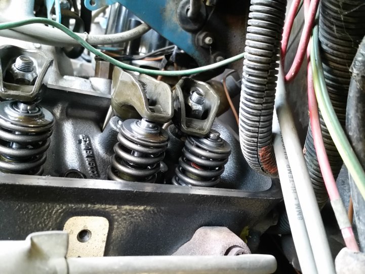

You were right @HotRodPC, it was evident what was causing the noise. I suspect I'll need to take off the intake too. But before I tear into it any deeper, what do you all think may have caused the rocker to rotate like that? Is that from a bent push rod? @BADAZ chevy guy @RetroC10Sport @raylanr
A recap, was driving down the freeway, truck ran great, no overheating, no missing, no backfire, just an odd noise, not a loud noise, but enough noise to be audible, and then it lost power and had a definite ticking sound on driver's side bank of the engine that can be heard with hood open. Starts right up, idles smoothly, has about 40 psi oil pressure, just no power
