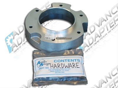

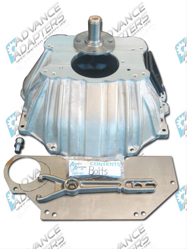

I was just looking at advance adapters site and seen a adapter for the long input cheaper than I can get a short input. so I just ordered a bell housing kit and the adapter for the long input round pattern 205.
I wanted to make this swap fast and easy the 1 ton its going in is a 4 speed truck already. I wont have to mess with the pedals or convert it to a hyd. clutch since I am using the AA bell housing.
fast and easy makes up for the money I just spent. really it would probably cost the same amount to adapt it any other way.
I ordered them from summit racing they had better prices and free shipping
460.00 for the bell housing kit and the 205 adapter
summit racing part numbers
bell housing kit
ADD-712577
long input round pattern adapter
ADD-50-6910
now I have to pull apart my round pattern 205 and swap out the slip yoke for a fixed yoke

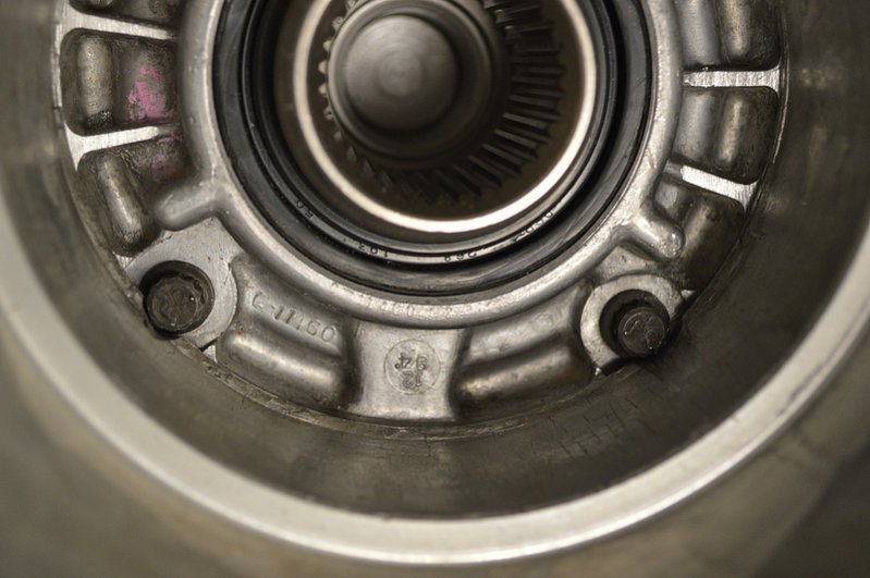

the nv4500 tail shaft does not have a mounting location for the shifter.
I am looking at the advance adapters bracket for the shifter to mount the stock shifter handle.
the short input will fit the nv4500 but you need to cut out a clearance wedge out of the mounting flange on the nv4500 and a little clearance work for the nut below the shifting rails.
and a little on the inside of the tail shaft housing for the bolts on the front of the 205
