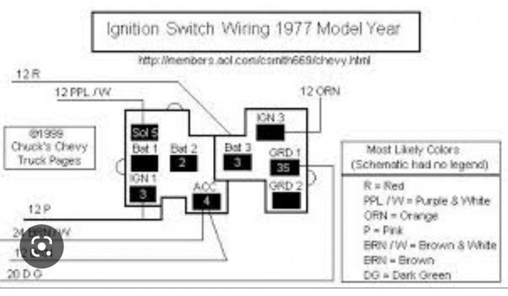

If you have no power on the yellow wire with the ignition in the crank position, you have found the problem. Now you need to find out why.
It’s easy to narrow down the potential problem area with a little detective work.
Disable the ignition, make SURE the trans is in park. Use a heavy gauge jumper wire, jumper from one of the red wires to the yellow wire at the ignition switch, assuming the NSS, starter and other wiring is good the engine should crank. If so, either readjust or replace the ignition switch.

Forgive my ignorance, which red wire are you talking about?

There is probably a couple red wires at the ignition switch, each protected by a different fusible link.
