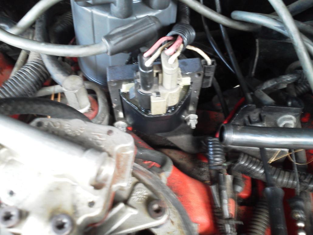

i just re-checked power to the coil and it does have power at the larger gauge red wire and to the dist. the smaller gauge pink or red wire doesn't have power with the key in the "on" position or when the engine is turned, but i assume that wire brings power back to the ign. mod.

Can you snap a picture of the wires in question? Pink would normally be coil power from a key switch position.
At this point in my mind, everything else is working, I am suspiciouse of coil power.
Edit: Check the pink and black wire going from the coil to the dist while someone cranks the engine over. That is the positive wire for the coil. should have power with the key on, as well as in in start/crank.
I think we are getting close.

the gray colored harness has power to the pink wire. the black harness has no power. the plug wire to the dist. has power
Ok, watch this guys!
if you have 2 straight pins, pierce both pink wires, and connect a wire between them,mthen try to start the engine.

ok so i put pins in both pink wires and ran a piece of wire between them. still nothing....

Ok, so you are getting power in the large pink wire going to the gray plug, and no power to the small pink wire in the black plug, right?
mhelms83
Jul 17, 2012
42
GA
Suburban V1500
350 5.7 TBI
correct.
