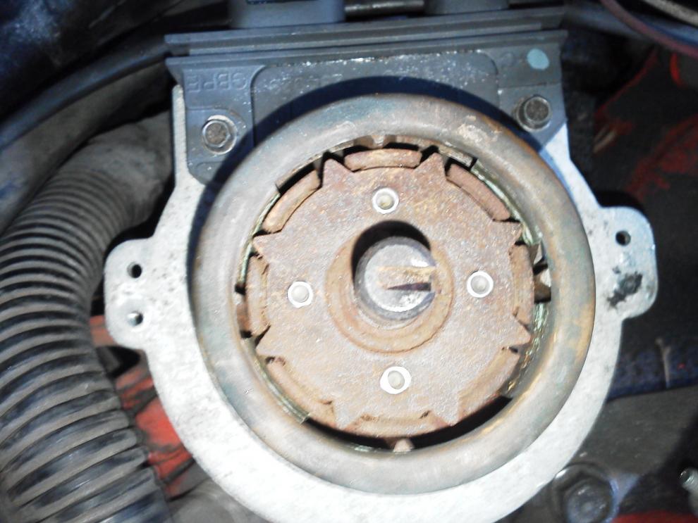

Your ECM is good then, and your ignition module is providing a reference pulse. can you take a pic of the top of your distributor for me?

here it is.

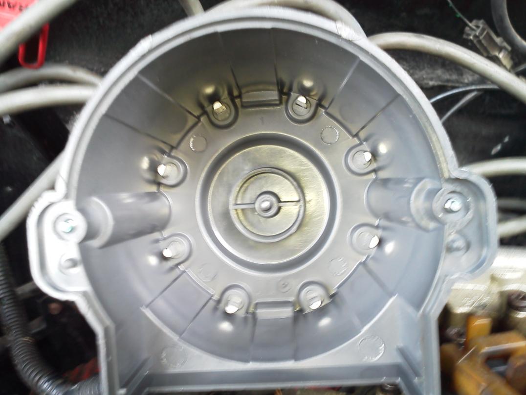

Ok, how about the top of the cap, and inside if possible?

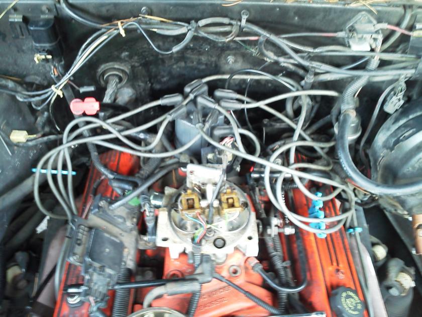

Post some pics of the engine with the air cleaner off too...the more eyes peering in there, the better. Are you comfortable with taking the ECM out and doing some electrical tests with a meter? There is one wire that I am suspiciouse of, considering the ignition is the only problem.

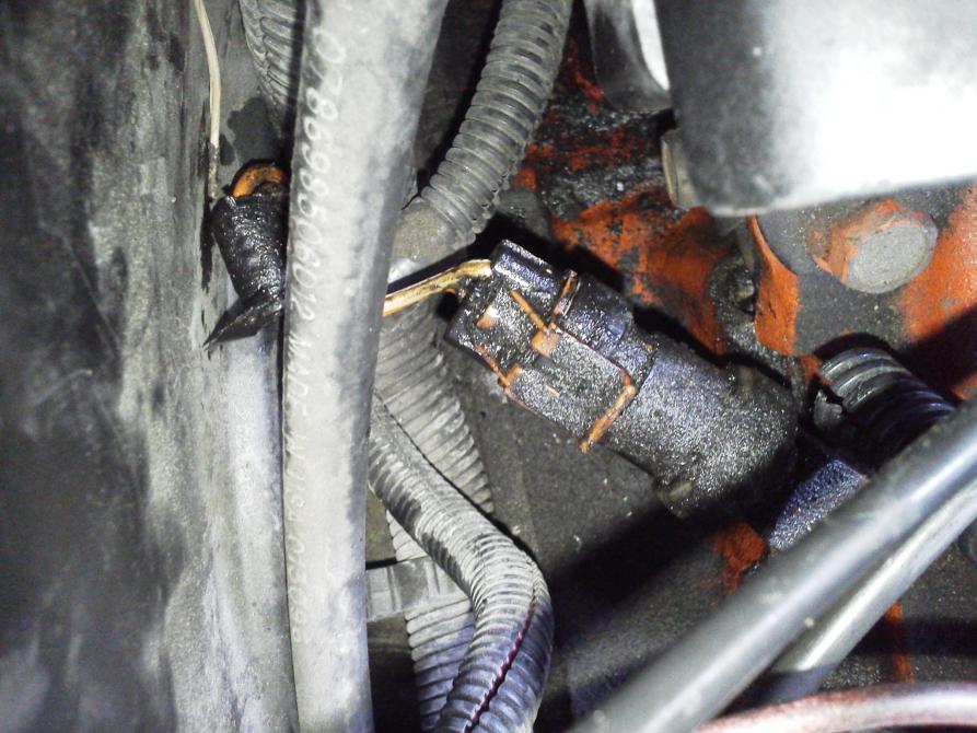

Yes the distributor is spinning. the dist. cap is new here's an inside view. Yeah im fine with pulling the ECM and doing some tests. pic #2: 1st off, i know my plug wires are a mess right now! The relay, just above the trans dipstick, i heard a "pop" noise come from that. There's no other wires to the dist. cap besides the coil and plug wires. Pic #3. I think this is the oil pressure sensor? I unplugged it and its filled with oil. Is this normal?

Holy ****!!!!!!!!!!!!!!
that firing order looks way off to me. Are you sure your distributor is in correctly? we have to be sure its correct before you can take it to a shop...it is GMSB regulations!
What do ya say we take it out, and start over!? and then re run those wires?
Did you remove the distributor from the engine when you replaced everything?...We are going to stick with you on this, bud!

ok, i did remove the dist to replace the pick-up coil because it was bad. ill pull it out and make sure to put it back right in the morning. so what about that "oil pressure sensor?" and the relay on the firewall next to the trans dipstick? would either of those cause my problem?
Nope. Are you familiar with finding top dead center? I dont know what your mechanical experience is, and i dont mean to make you feel like an idiot in any way, but you are willing to make the effort, which is enough to get this figured out...even cross country.
