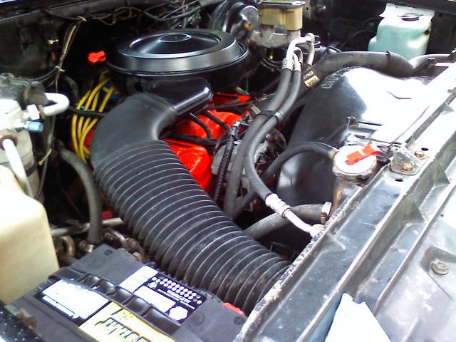

I dont have a code reader so it hasn't been tested yet. I did verify that it was getting power at both the fuse panel and the plug (pink wire) Is there much more to the ignition system? Could a bad starter solenoid cause the problem? I think ive tested or replaced everything else. Oh, and a pic of the engine compartment. Tell me what you think.

You don't need a reader, just a paper clip and count the flashes.
Not sure if there is a write up in here on that or not, let me look.....

You dont need a code scanner, you can diagnose with a paper clip and watching the check engine light.
Your diagnostic connector is under the dash, below your steering column. Jump A and B together with a wire or paperclip. the first code you will see, is code 12....1 flash, a short pause, and then 2 flashes. each present trouble code will flash 3 times.
Just turn the key to the on position after you jump the terminals with the paper clip, to the point where the dash lights come on, DO NOT TRY TO START THE ENGINE!
