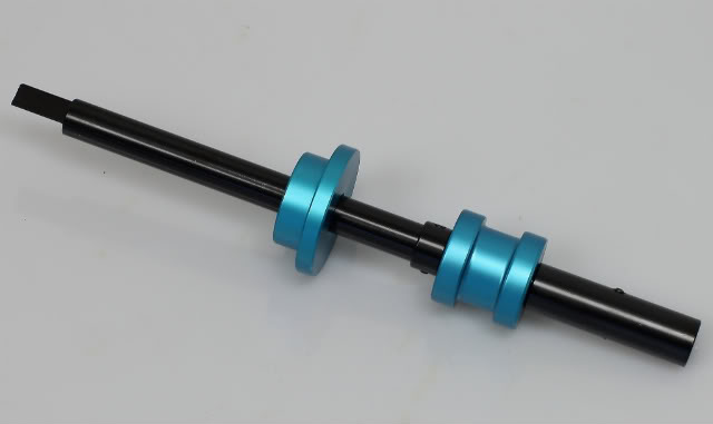

One last question - are you using a modified distributor for a priming tool? A SBC cannot be primed all the way with just a shaft driving the oil pump. You need to use an old distributor. There is a collar on a SBC distributor shaft outer housing that seals off the end of the cam passages and forces oil up the pushrods to the lifters.

I prime until oil comes out of the top of the pushrods, which takes a long time.
Ive attached a picture of the tool

I've got an old dizzy that I've ground the teeth off the gear and cut the rotor mounting plate off the shaft. Its the perfect priming tool since it allows proper oiling to get to the top end of the engine, and not costing me anything is an added bonus :rockit:
I built one of those too. Shoves the oil to the left side of the engines top end.
Without it, there`s oiling only 1/2 of the engine.
