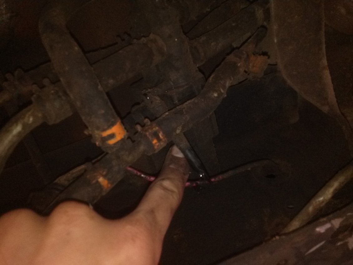

I ran the truck today and gas started pouring out, looked under the truck near the passenger gas tank and a fuel hose looks like it burnt through. its a real flimsy tube. There is no sign of where it is from

That's a vent of some sort for the tank switching valve. You can try operating the valve several times and see if that slows the leak, but the valve is probably failing.

A guy told me to blow compressed air into the gas cap hole to get fuel moving. maybe i blew something up in there.
35,196
43,885
Could have. The tanks are vented, but the vents can plug up with dirt over the years.
