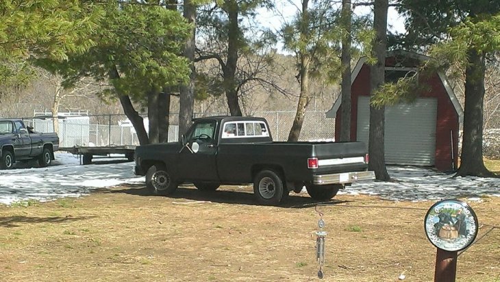

As far as I know Radial T/A's don't come in 16's. I've never done any towing with the truck it's just gonna be a weekend cruiser. I'd stick with my Turbines but 16.5's are next to impossible to find
